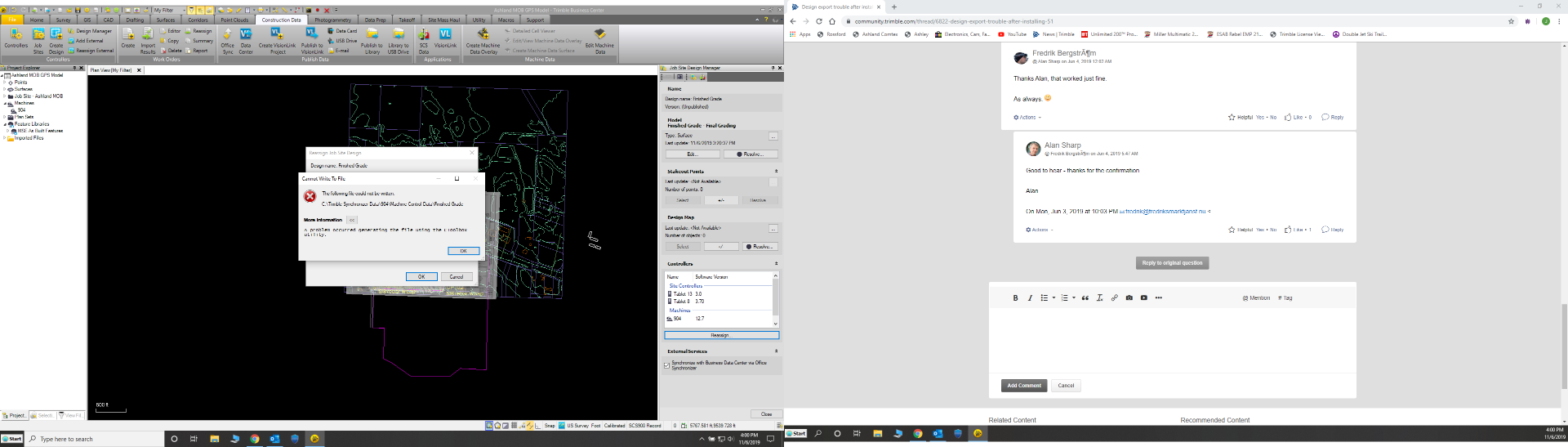

    Hi!
    Suddenly i cant create designs anymore. I have reinstalled TBC twice with no luck. Any ideas?

    Posted 06-03-2019 10:03
    Exporting 3D Linework is working for me - I guess that you need to de-install and then run the Cleanup Utility and then reinstall clean once more. I will locate and post the latest cleanup utility this morning
  • 5.  Re: Design export trouble after installing 5.1
    Posted 06-03-2019 10:16
    Thanks, will you post it here?
  • 6.  Re: Design export trouble after installing 5.1
    Posted 06-03-2019 14:47
    Here is the Link Frederik
    You will see in the Useful Tools Blog Post that there is a known Cleanup Issue for the CToolbox which I believe is the root cause of your issue today.
    Click Here
  • 7.  Re: Design export trouble after installing 5.1
    Posted 06-03-2019 21:02
    Thanks Alan, that worked just fine.
