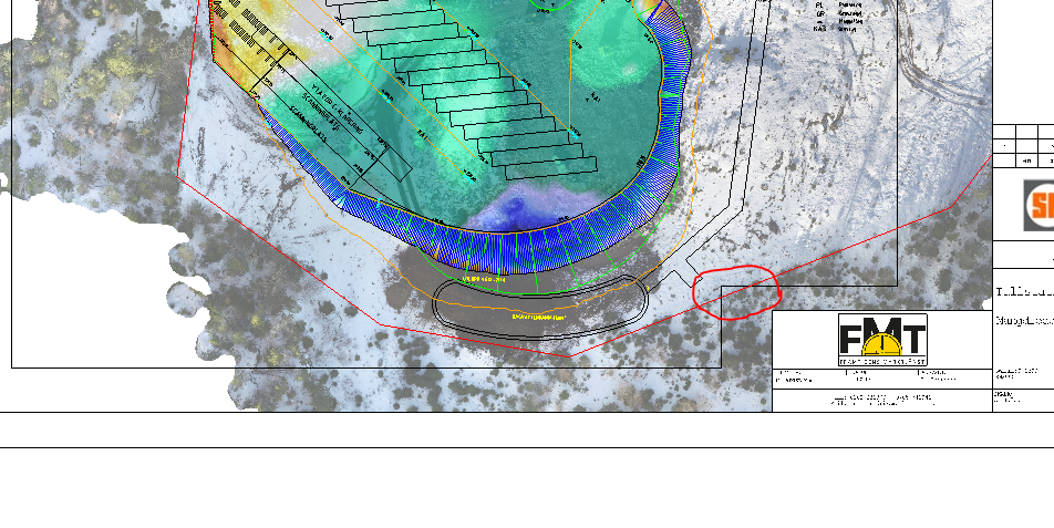

    I have a line that shows up different depending if i see it in the planview or the plotview. In the plot it also shows up wrong.
    Line shows up wrong in plotview and in plot - YouTube

    I think I found the problem. I created a new plotbox with scale 1:1000 insted of the old one that was 1:800. As the screendump shows, the old plotbox cuts the problem-line were our logo is placed. It seems like that causes the line to change into a different position in the  sheet view. It´s still an issue though.

    Thanks magnus@fmtmark.se">Magnus Bengtsson, that solved the problem!!!

    What kind of line was it - a Boundary, Linestring, Polyline? or ...
    I need to try and reproduce that
  • 5.  Re: Lines showing different places in planview and plotview.
    Posted 02-15-2019 12:40
    Linestring.
  • 6.  Re: Lines showing different places in planview and plotview.
    Posted 02-15-2019 13:50
    Please send me the file - you are evidently double or triple clipping the line and the key nodes are being clipped away and it is getting the resulting shape wrong

    This is one of the projects that i am having trouble with the plotting because things shows up in the plot that should not be there. Because of that i have made a plotbox for every plot, is that the problem? That i have more than one plotbox at the same spot?
