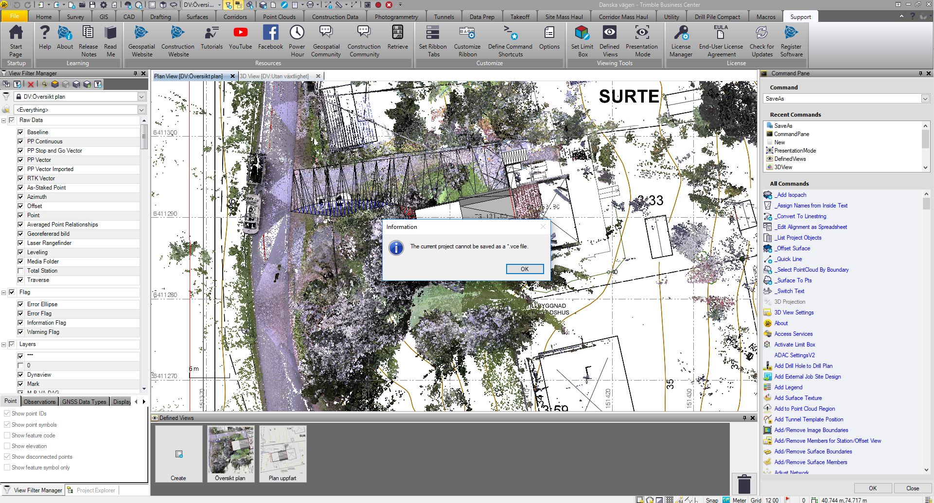

    I Tried to delete that folder and it did not help im afraid, also saving the project with a new name also doesent help me because thats the old project.
    1. if i open the project file with the trimble logo, it opens a older project. I am missing a drawing wit a cut n fill map.
    2. If i open a empty project and drag n drop the .vce-file into the project it will open the newest one. I can save it by pressning "save" but i cant use "save as" because TBC tells me that i cant save that file as a .vce file.....
    So right now my only way to be working with this project is to drag n drop the .vce file into a empty project every time and when i am finisched i have to delete the oldest vce file and keep the newest.

    So this morning I tried using your steps and drag-n-dropped a project.vce~ file into my v5 window. I made a change and tried to rename it with Save As. Like you say it's not allowed. Then I saved it and I now had a project.vce~~ file. I closed the project and did a drag-n-drop of the project.vce~~ file. Sure enough the changes I made were there. I changed a layer color and again saved the project. I now had a project.vce~~~ file. I closed that project.
    In file explorer I did a right click on the project.vce~~~ file and selected Properties. The full name appeared in the top box. I renamed it by removing the ~~~ and adding a different name called project-test.vce and hit OK. A warning that it could cause problems popped up and I hit YES to change it. In TBC I chose File->Open and in my projects directory chose the project-test with the TBC logo. When the project opened it had all the changes I'd made.

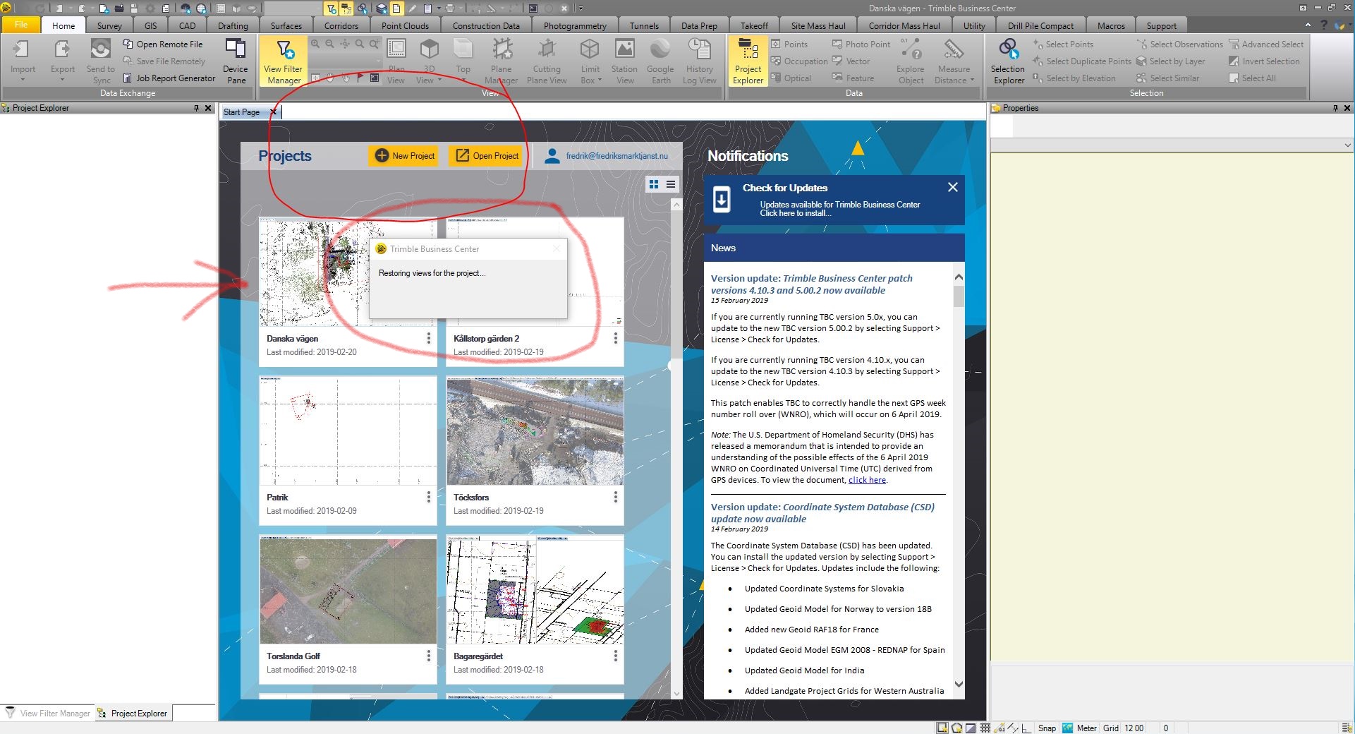

    Now i have this problem again. I have been working on this project some days now and this morning i cant open it again. It only says "restoring views for the project" and get stucked. It never opens and i have to use ctrl+alt+del.
    The strange thing is, as same as last time, Magnus can open this project without a problem on his computer and save it. I cant....

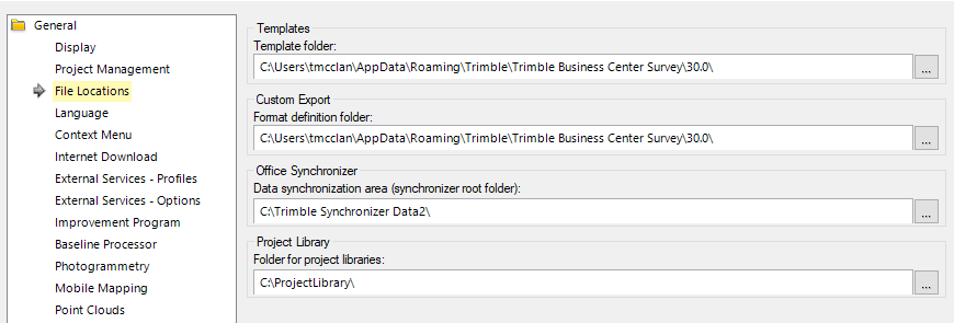

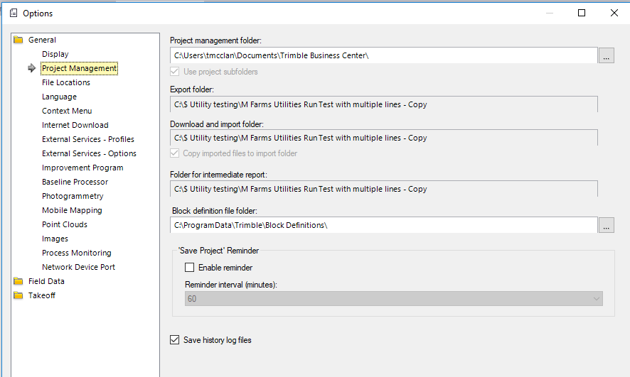

    Please send me a screen snap of your options, project management settings and file location settings: as shown below.
    The view settings for the last several projects are stored in the folder:
    C:\Users\tmcclan\AppData\Local\Trimble\Trimble Business Center\31.0\ProjectViews
    (use your name rather than tmcclan).
    Erase or rename this folder and try to open the project again.
    It could be the view settings are getting corrupt or there is a problem with permissions.  It could also be that the path to the information is too long or is changing.
    Let me know if this works.
    tim

    This is strange. 2 days later and a coulpe of restarts the project will now open the correct way. 2 days ago i waited almost 2 hours and the gave up.

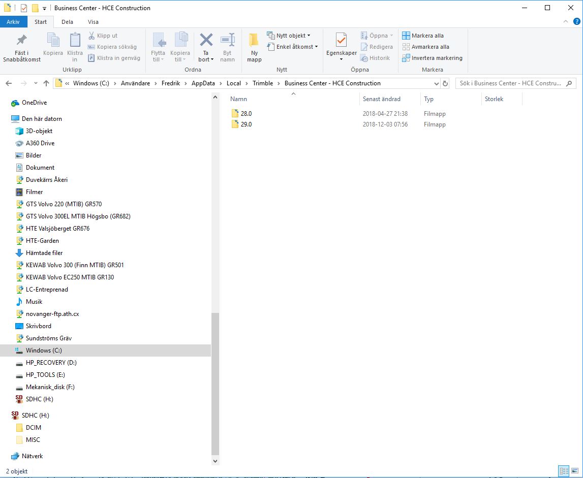

    Here is some pics from my settings and folders, i dont seem to have the folder "31".
    One other strange thing is that when the project now opened it was with the "Toggle line marking" turned on. I knoww that it was not turned on when i closed the project because i almost never use this function. The problem now is that i havent been working on the correct file due to my problem so i now have to continue to drag n drop my "Danska vägen.vce~" because that file cant be saved as the original .vce-file. Or is there anyway around this?

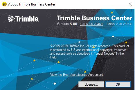

    Also are you running the patch version? (5.0.6956)
  • 14.  Re: Open some projects with .vce drag n drop, but problem when saving. Any ideas?
    Posted 02-21-2019 22:16
    Yes.

    #1 Eliminate dropbox as a variable.  Keep your files locally without any type of syncing.  I suspect that this is the root of your problem.  TBC is recording every command you run and the options used in a history file.  This is a constant activity which could cause a syncing issue.  You can turn this off in the project management tab of the options command.  Every change you make is recorded in an undo buffer file.  If you delete or change objects they get written to a file so that you can later undo the changes.  This would also cause a continuous syncing problem. You cannot turn this off.  If you have files that you cannot open, copy them to a local folder and see if that helps.
    #2 Try and keep your file paths short.  Windows has a limit of the number of characters that can be used in a path.  TBC automatically creates folders for images and other items that can try to exceed the limits of windows.  Files of a length that work can be copied to a long path that cannot support the new length.  If they get renamed in the process then applications may not be able to find them.
    #3 If you need to use the backup file (.vce~) rename the original file (.vce to something else) then rename the backup to the name of the original file.  This will keep the proper links to related files and folders.  In normal operations you should not need to do this.  I don't think the original file is corrupted, there is some permissions or other reading operation that is failing.  It could well be that dropbox is doing something in the background that is making TBC unhappy.  I would archive the project, move it to a local folder, check the file permissions and then try to open it.
    Let me know if using a local folder helps.
