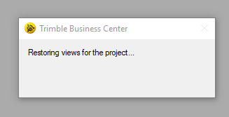

    Thanks Alan. Any idea why i cant open some projects and why its just says "Restoring views for the project"? I did open a priject this morning, closed it and another guy in our company did some work in the project and saved it. Now my computer has tried to open it for 2 hours, i have tried to restart and open it i different ways but it just wont open, it only says "Restoring views for the project". He said that he had a lot of problem when working in it today, a lots of crashes and hang ups but that could also be hes computer it is not the best one.

  • 9.  Re: TBC 5.0, SLOW!?
    Posted 12-09-2018 11:08
    Open a blank project template, drag and drop the original  .Vce file into it. That's how I got them to open.
    Thanks!

    When i do that it just try to open the project, not opens it in the blank project so it gets stuck again. When you do that, does it open inte the blank project then?
  • 11.  Re: TBC 5.0, SLOW!?
    Posted 12-09-2018 11:22
    Sorry, im dumb!! Of course i took the wrong file to drag n drop, it worked!!!!  Thanks!!!!!

  • 12.  Re: TBC 5.0, SLOW!?
    Posted 12-09-2018 11:31
    I've found that after I do this, the project will open normal again.

  • 13.  Re: TBC 5.0, SLOW!?
    Posted 12-09-2018 11:28
    Try CTRL Shift drag and drop the VCE over the Start tab of TBC

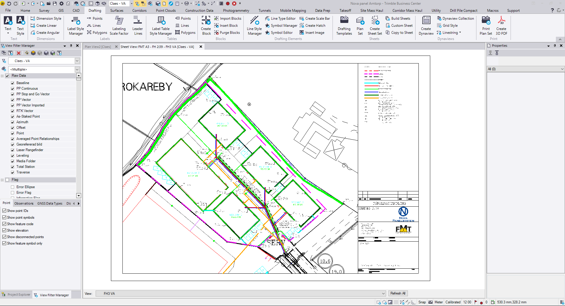

    @Alan Sharp, are the guys working on the plotting to? Because the problem with stuff showing even that i choose "hide members of selected" is back.
  • 23.  Re: TBC 5.0, SLOW!?
    Posted 12-05-2018 15:00
    Frederik
    I am not sure I understand the question or the steps here
    The Plot Sheet has a Dynaview
    The Dynaview has an assigned View Filter
    Whatever is displayed by that Viewfilter will show up in the Dynaview on
    the Plot Sheet
    If you turn things on and off in the Plan View using a different View
    Filter to that used by the Dynaview it will have no affect on the Plot Sheet
    To affect the Plot Sheet - you need to select the Dynaviews View Filter and
    then change what is displayed by the View Filter - it should update the
    Sheet View automatically - sometimes you may have to refresh the Sheet View
    to get it to update - without having your project to look at it is hard to
    guide you further here
    I will post a video that may shine a light on what you are trying to do

  • 25.  Re: TBC 5.0, SLOW!?
    Posted 12-05-2018 15:40
    Erik,
    Here is a short video on how to use Dynaviews and View Filters - Hope that this may help. I will record a second video to show you how Selection Sets might also be added into this mix if you want to display "randomly selected items" on a plot sheet that are scattered across many layers that contain objects that you do not want to plot.
    Here is a video on using Selection Sets, View Filters and Dynaviews to create Plot Sheets
    Note that a View Filter that has a Selection Set applied goes together - if you change the View Filter the Selection Set is removed, if you reapply the View Filter with the Selection Set then the Selection Set is automatically reapplied.
    You can have multiple Selection Sets enabled in a View Filter
    When you have a Selection Set applied you can Set the Selection Set to Display or Hide the selected Selection Sets.
    In this way you can pretty much control whatever data you want in the View Filters applied to Dynaviews.

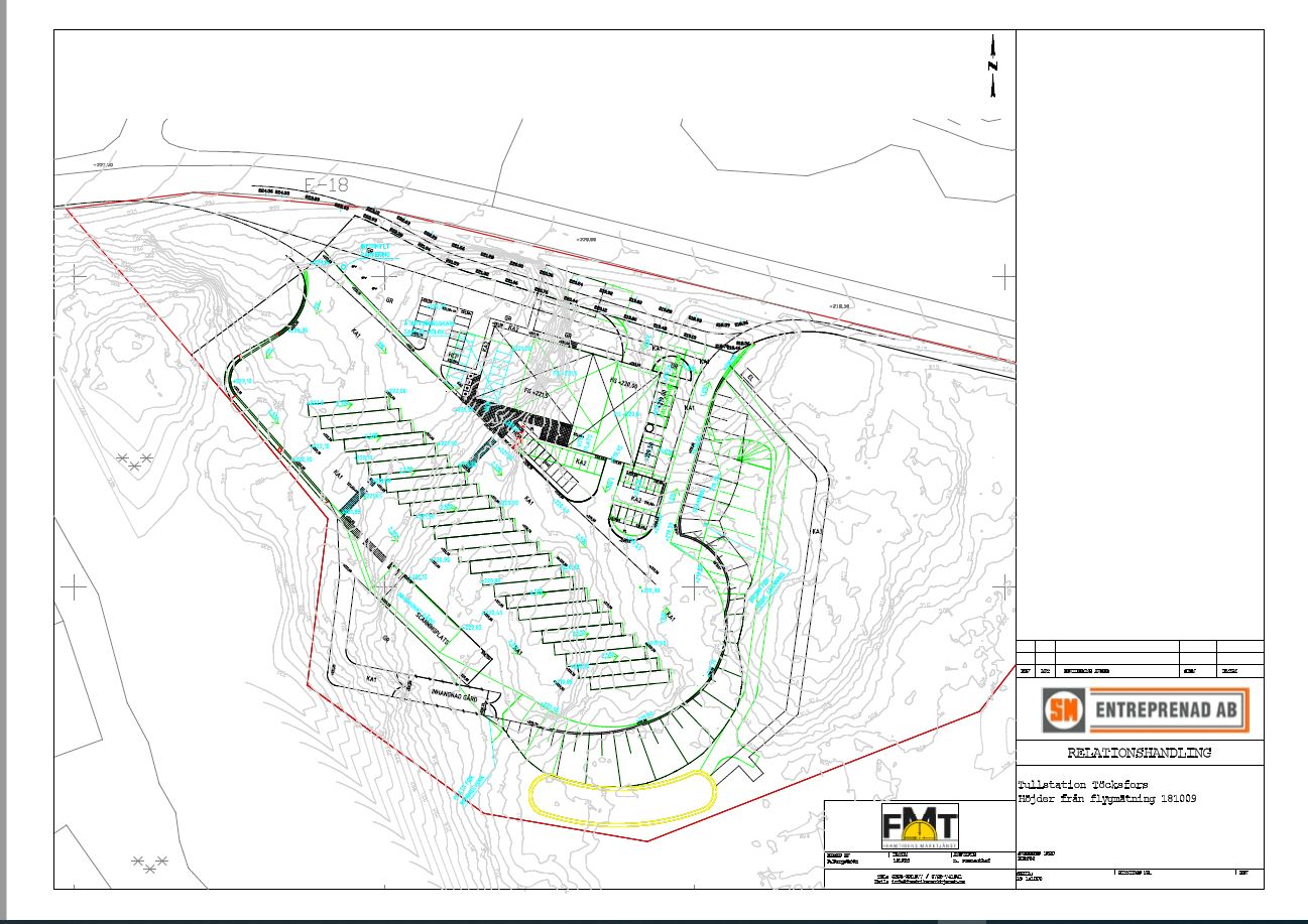

    What happens if you try to plot the view to a pdf? In the plotted file the "turned of" things do show, but it works in the screen.
    Right now i am trying to open the project i had this problem in, it says "restoring views for the project" for about 10min now.

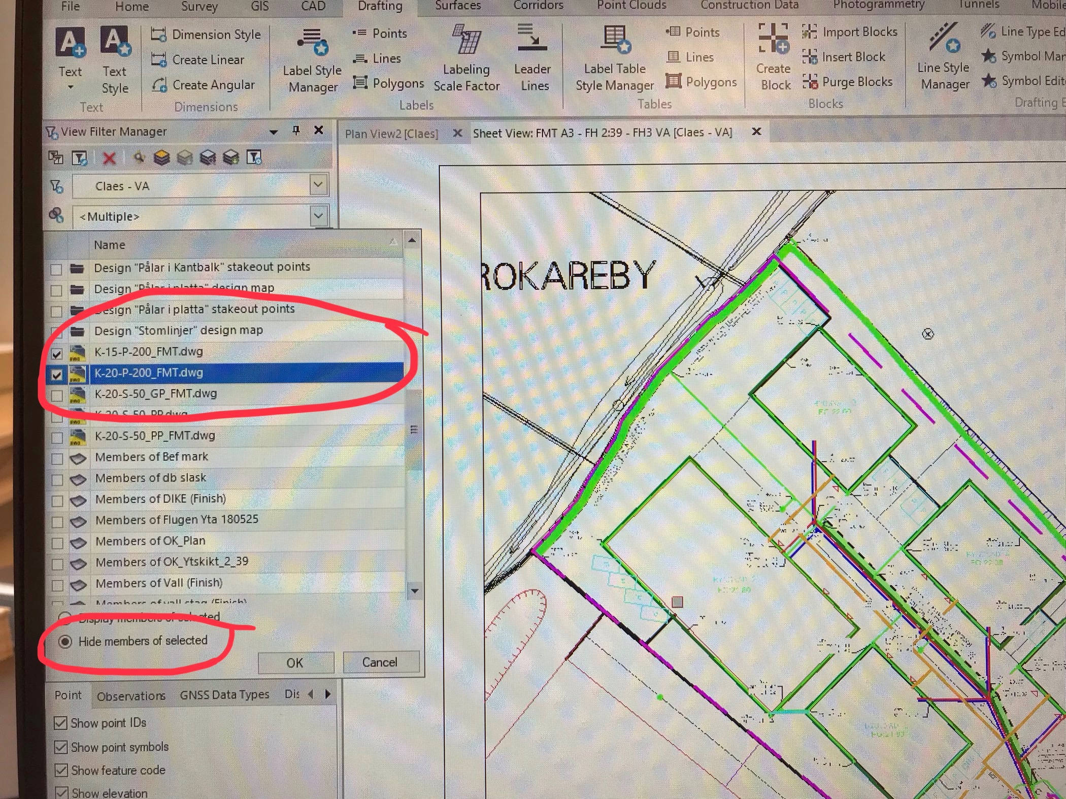

    I had this issue last week where I get my selection set working in the sheet view but once I plot it to a pdf, nothing shows up at all. Does the Titleblock and Dynaview have to be in a selection set as well and have that selected on the filter?
  • 28.  Re: TBC 5.0, SLOW!?
    Posted 12-11-2018 09:57
    The View Filter (and selection set) applied to the Dynaview(s) will dictate what shows up in the Dynaview area of the Plot Sheet. The View Filter applied to the Sheet View will dictate what gets sent to the Plotter or PDF File. If the Sheet set up looks right in the Sheet View then that should be what goes to the PDF File. The Sheet View View Filter needs to have the Dynaview Layer as visible in order to show the content of the Dynaview. It also has to have the Titles and Borders layers visible.
    This is one of those things that without having the data it is hard to say what you are doing wrong, but the above is the general rule that I would apply.

    Hi!
    I tried to print a pdf now but it does not come out on the pdf as it is shown in the sheet view.
    This is the sheet view:
    sheetview
    and this is the settings that seems to be the problem. I have turned some dwgs to "hide members of selected" in the viewfilter assigned to the dynaview I use. That works fine in the sheet view but when I print that sheetview to pdf the hidden dwgs still shows up.
    settings
    This is what the same sheetview above looks like when printed as pdf:
    pdf
    Is this only on my and Fredriks computers or is it a problem for anyone else?

    Hi Alan, I had the 'restoring views for the project' screen locked on also, and attempted deleteing the *lk lock in the same way. That didn't enable the program. I had been opening the software using the TBC icon on my home screen.
    I've since been going to the directory folder and open directly from the *.vce icon in the project directory. Admittedly it doesn't solve all problems, but has worked well thus far for existing projects.
