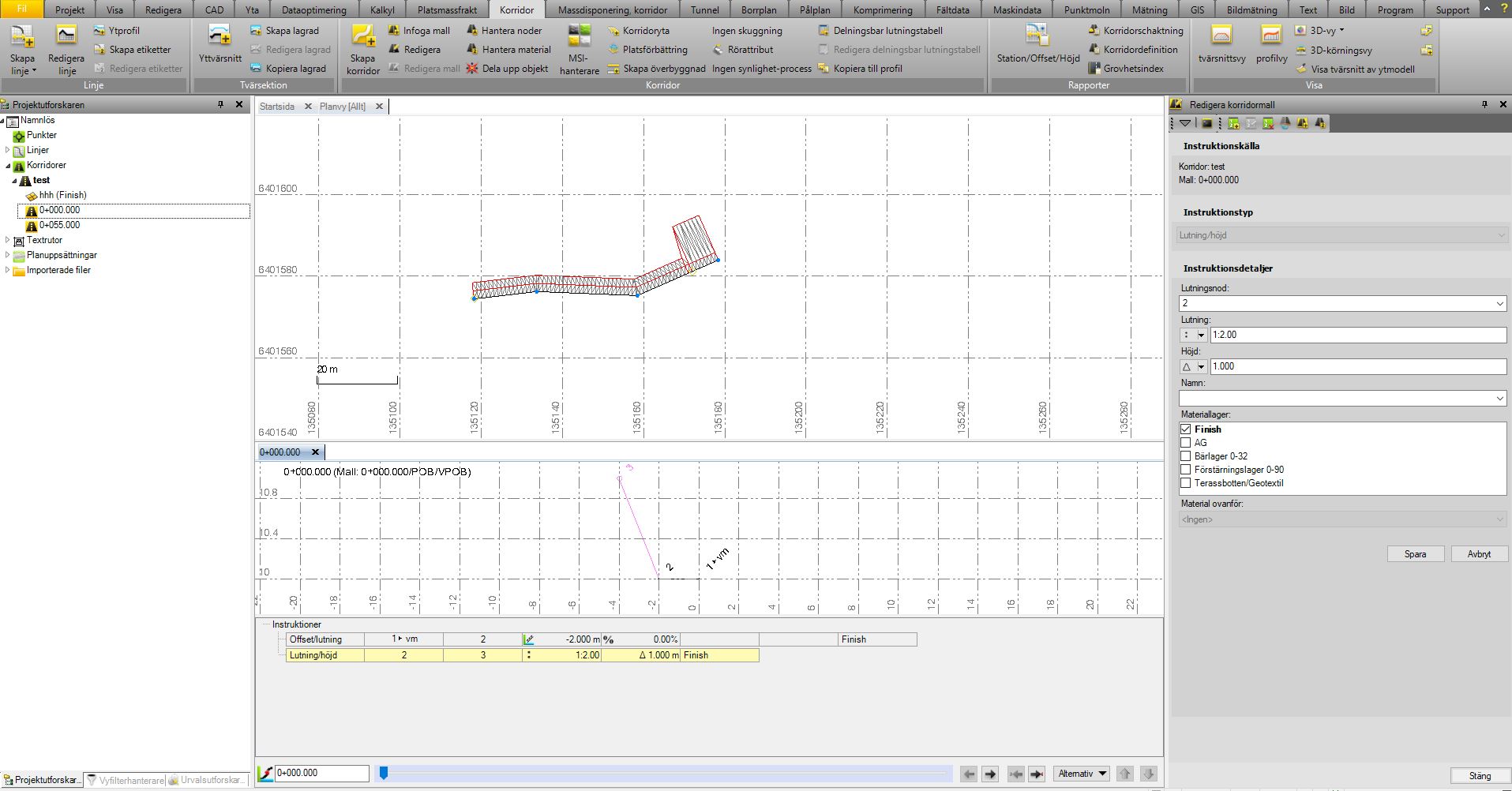

    Hi!
    I have some problem with my templates in a corridor, i dont understand why the interpolation dosent work like i want it to do. Anybody know why?
    Here is a video  Corridor question - YouTube

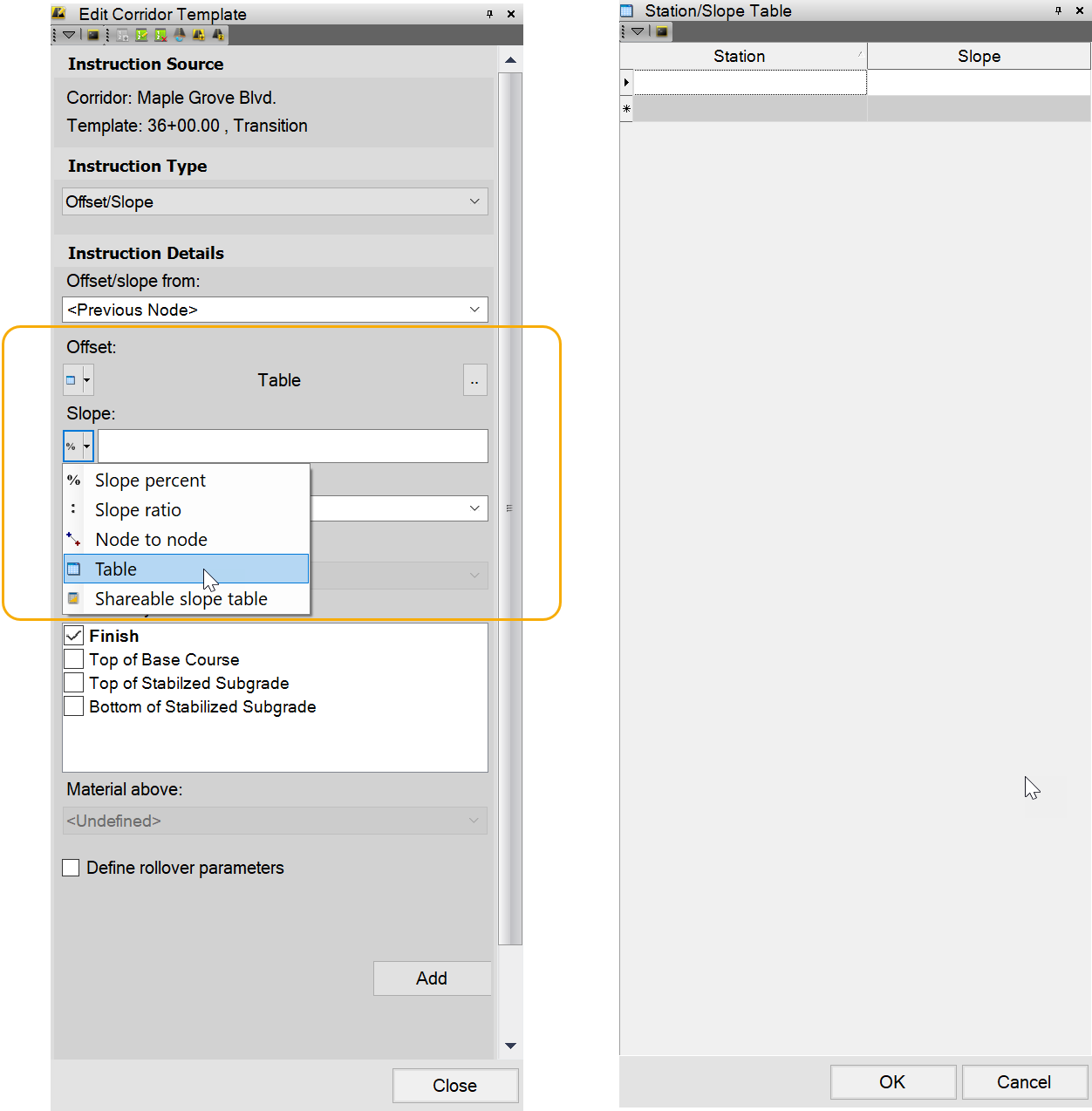

    Hello Fredrik,
    I cannot tell from your video which method the template is using, but using an offset/slope or offset/elevation table for the instructions in the final portion of your corridor may help you achieve the slope you need. Using the table, you can dictate exactly the node elevation or slope at each station along the corridor; the slope in between is interpolated.
    For more information, see step 5 in the Create Offset/Slope Instructions help topic. If you have any trouble, don't hesitate to message me/send me your file to review.

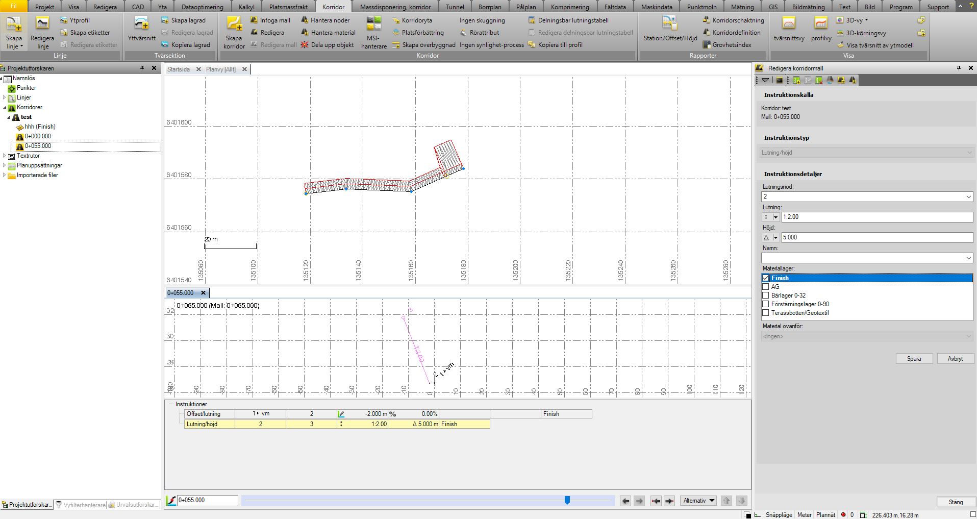

    Thanks,that did it!
    I thought that it would interpolate between the nodes and stations, it has done that before i think? Like i did in the example in this pics.
    Station 0+000Station 0+055
