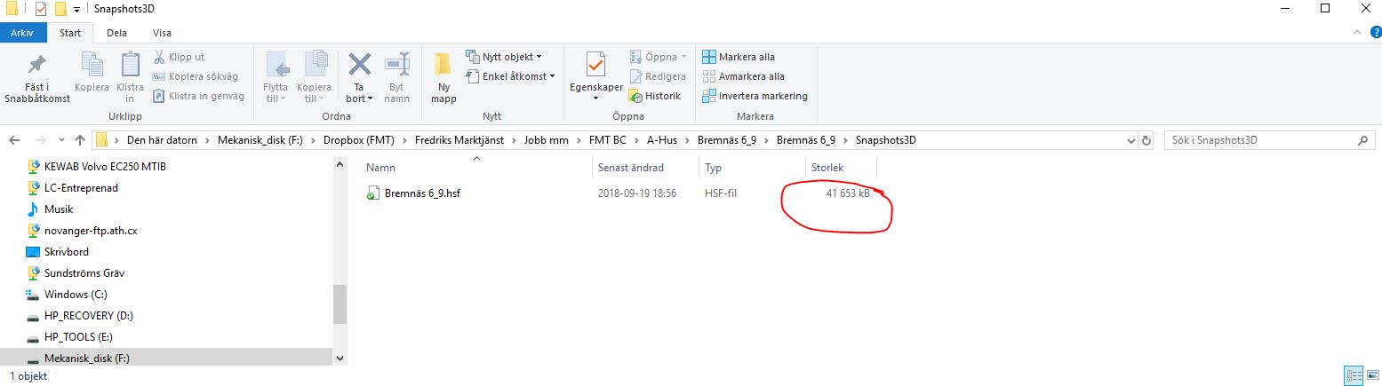

    Hi!
    its me again......;)
    Look at the pictures, does anybody know how to use the files when they are published to TCC? Should i be able to view 3D-files  or is it just for sharing files? Just testing things right now.

    Ok. So what is it? I can´t import the file to businesscenter after exporting it. It has to be something, its 42mb.

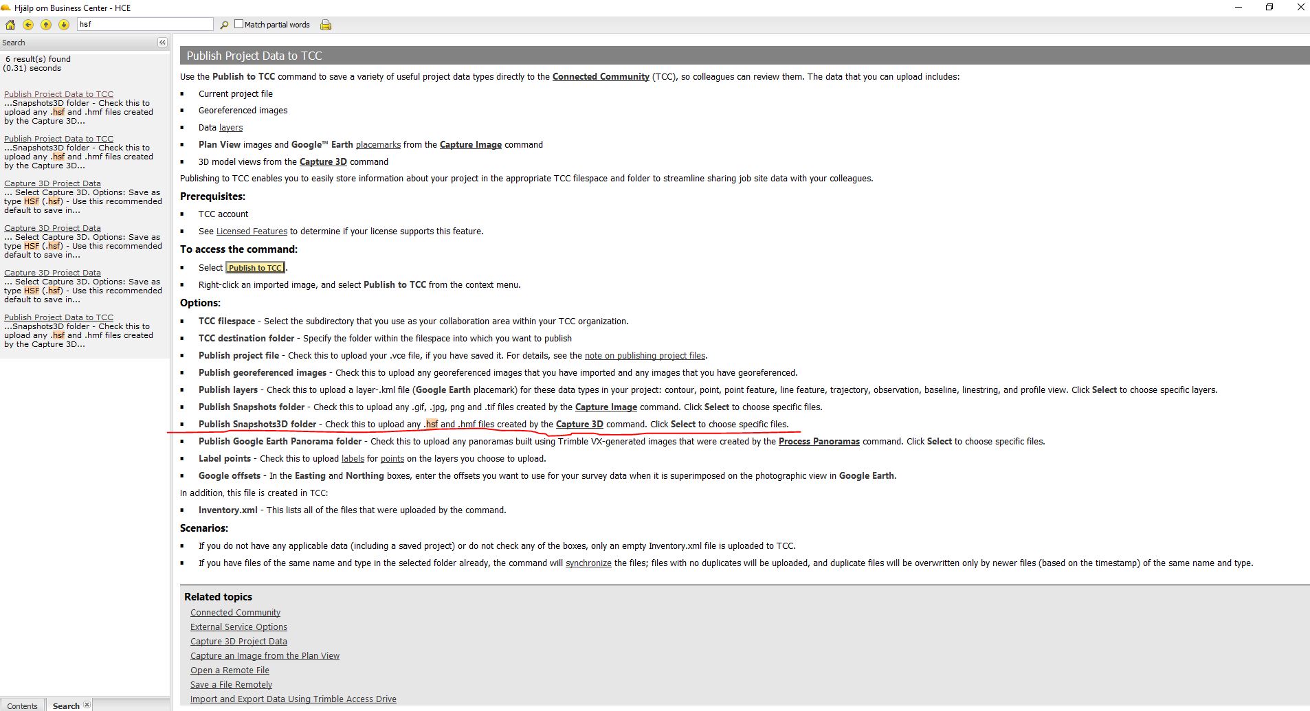

    The Publish to TCC command creates a hsf file (as one of its outputs) along with the BC-HCE Project File etc and the Georeferenced Images etc that you have in the project. The .HSF is a Hoops Streaming File and can be used with the Hoops Streaming Viewer called Hoops Visualizer.
    Hoops is the Graphics Engine that we use in BC-HCE and that is used by other CAD products like AutoCAD and Rhino etc (as far as I know). The Hoops Streaming Viewer can be found at this location
    Download Hoops Visualzer (For Desktop)
    TCC used to have a 3D Viewer that supported this HSF file that has been discontinued - but the HSF viewer is still supported by Techsoft
    I have not used this Visualizer product (they used to have an Online Service that you could load the HSF files into but it seems that they have moved to this Desktop Product now as the HSF Viewer. I just downloaded it and while it provides the viewing tools to HSF files, you will get a better experience using LandXML files with Connect or Connect Desktop than you will with this HSF Visualizer.
    Using Publish to TCC allows you to save your entire Project to TCC as a Backup or in order to share using TCC as the Web Service.
