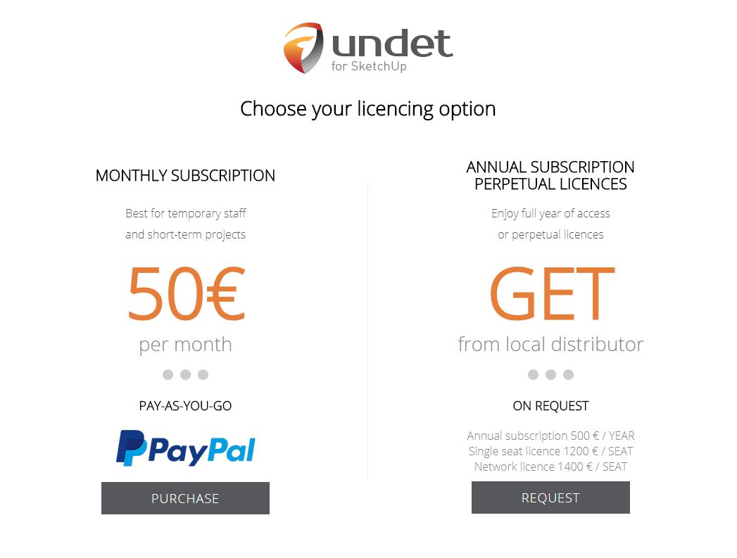

    Thanks.
    I was hoping for an solution with the extension for realworks. If that is possible i dont have to pay 50 euro a month for a subscription. I rather give that money to Sitech for another Businesscenter license.
    It will also give me more possibilities with my sitevison, a easier workflow.

  • 5.  Re: Pointcloud from SX10 or BC-HCE to Sketchup, is that possible?
    Posted 07-04-2019 06:20
    You don't need to pay a monthly subscription each month. You can buy a 1-month license for 50€ when you need it without any commitments.
