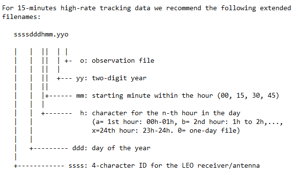

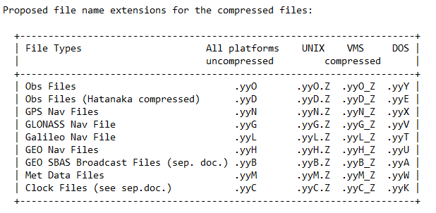

  • 4.  Re: DI have 2 large to2 files which occupied 24h per day so i want to merge these 2 files into one single file so how to do it?
    Posted 05-06-2019 23:33
    Can't be certain Alan, but I'd have thought if the break between session was much larger than the epoch recording interval, then TBC would not create the session file join.
    Most of my experience with this relates to CORS files with the old (RINEX 2.11) Standard naming conventions. TBC seems to handle this well:
