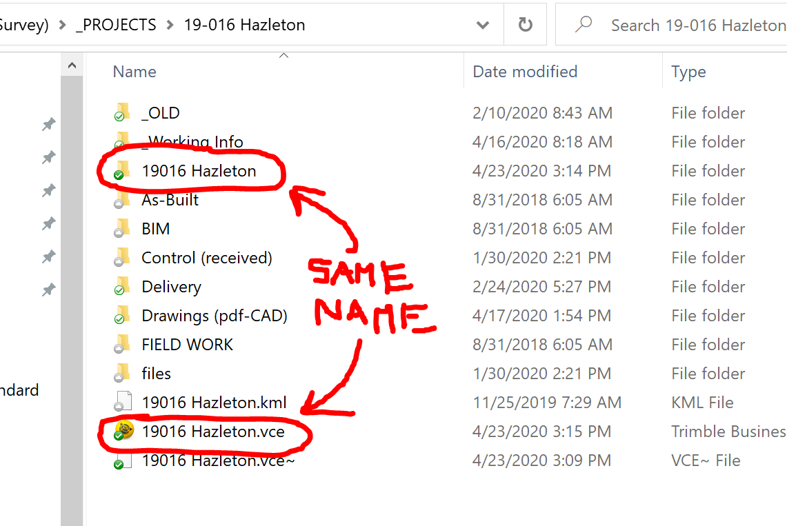

    The pdfs are stored in the subfolder of the project name.
    So, my project location is
    C:\Trimble\Projects\ACTIVE\1000-CUNFS\10-19-18 SW TOWER STAKEOUT.vce
    There should be a sub folder
    C:\Trimble\Projects\ACTIVE\1000-CUNFS\10-19-18 SW TOWER STAKEOUT\
    If you were to look in there it should have all your imported files as well as the PDFs images
    C:\Trimble\Projects\ACTIVE\1000-CUNFS\2-21-18 NORTH FORK SIPHON\SURV CONTROL_Page001_Dpi300_Layer043.png_tiles
    That needs to be transferred over to your server as well. Not just the VCE.

    To further visualize what Erik is saying:
    Both need to go to your server.
