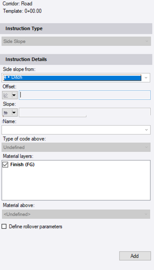

    I updated to TBC v5.30 today, and I use a set of 4K monitors as well as a laptop workstation. I've been creating a corridor for one of our project for the past few days, and have noticed some unexpected behavior within the "Edit Corridor Template" panel. I did not experience these issues with previous TBC versions. I've uninstalled and reinstalled, I've repaired, and I've used the Trimble Cleanup application, but still experience the same issue.
    While using TBC on my 4K displays, the GUI (drop-down menu, text boxes, check marks, etc) within the Edit Corridor Template command do not update or behave 'actively' (drop-down menu opens, but the options don't highlight when hovered over; text boxes act frozen with no blinking text bar or blue highlighting, although they do apparently still receive input, though I can't see what I've typed in them; check boxes don't update when clicked, etc.). These issues act as effective blinders, because I can still modify my corridor templates, I just can't see any of the changes that I make to the user input fields.
    When I lower my monitor resolution, these problems go away (the highest resolution that I can successfully set my monitor to is 2560 x 1600). The issues are also not present when I have TBC displayed on my built-in laptop monitor. I have not seen any other obvious issues related to these ones; I can pan around my project, objects (including the corridor I'm editing) update when I make changes, and buttons highlight as expected when I hover over them. The only command that I've seen this issue with is Edit Corridor Template.

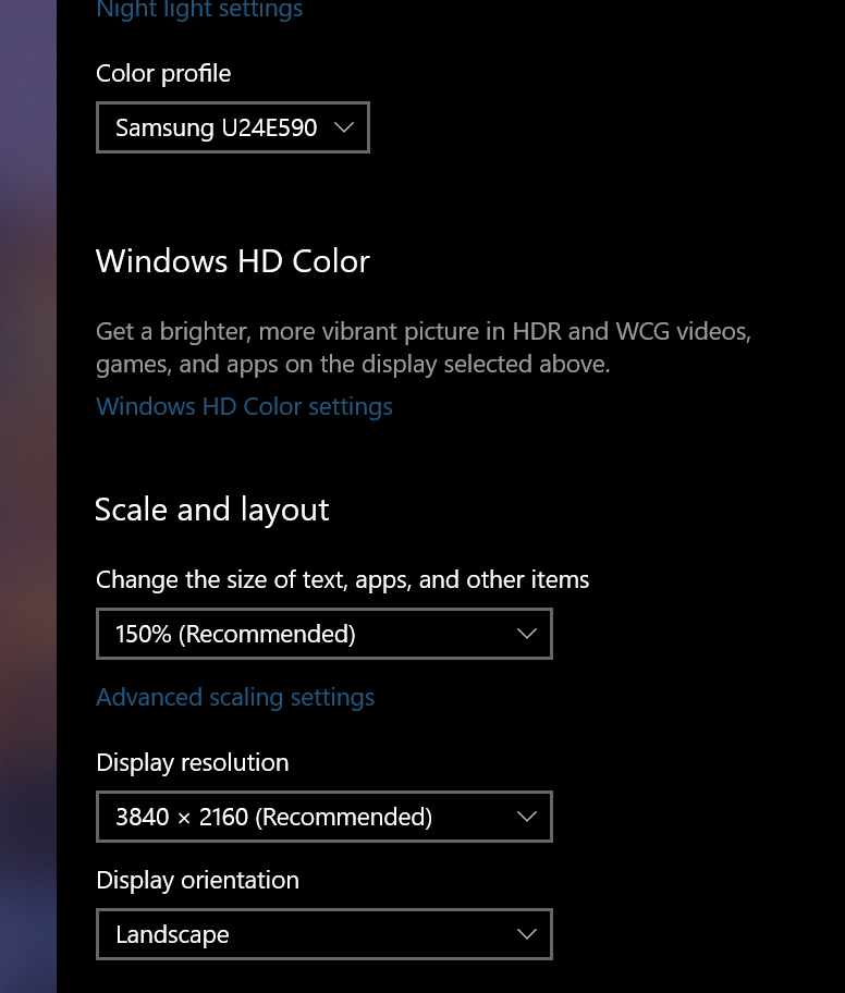

    Weird - I run 3 4K Monitors and just restarted this am and ran Corridor Template Editor no problem at all
    I run mine at 150% on an External Monitor and 200% on my Laptop 17' monitor. I set my External Monitor Right Side to my main display (used to use my Laptop as main display but find that the 4K Resolution on my large Monitor has a positive effect when running the full 3 Screen approach as that drives the scaling of the graphics on all monitors in TBC.
    Could someone screen video to share with us - we will need to see which monitor settings you have for each monitor, which monitor is your main monitor, and then show us what is happening in TBC that is the problem.
    Try changing your best monitor to be the Main Monitor and use that to scale the other monitors.

    It is just one monitor.
    The offset does not blink and cannot be moved. Basically it all just sits there. W10 Home. Nvidia GTX 1070 Samsung 28" 4K. I can change the drop down but everything else is untouchable.

    You can try setting one of your external 4K Monitors as the Main Display - this then uses that monitor to scale the size of Pixels on all screens that are attached. This can give you a better behavior in my experience.
