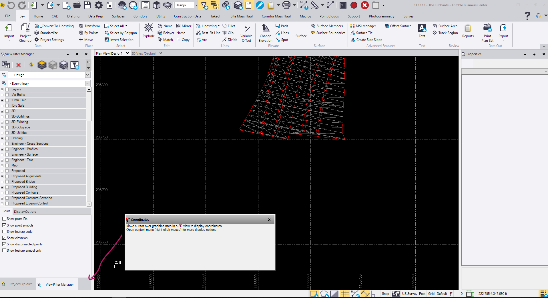

  • 5.  Re: Is there a setting I need to use to keep the coordinate scroll docked and active in a .vce.
    Posted 02-12-2019 07:07
    I cannot get the coordinate scroll to dock above the "View Filter Manager" and "Project Explorer" tabs shown in the attached image. This was a tough enough challenge in TBC 4.12 but it seems to be even trickier in TCB 5.00.1.
    Any tricks on this? I tried using just one screen and still no success.
  • 6.  Re: Is there a setting I need to use to keep the coordinate scroll docked and active in a .vce.
    Posted 02-12-2019 08:43
    I found today that when you have VFM and PE open in a shared tab that I could not dock below it - I closed PE and then docked the Coord scroll and then reopened the PE and it all worked OK for me
