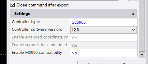

    I just tried a Surface only and a Surface + Linework file and neither locked up TBC for me - what settings have you enabled in the export before the lock up occurs? i.e. what version of GCS900, and the other associated settings as shown here
    So it sounds like an installation problem to me rather than an application problem - I would try deinstallation, running the Cleanup Utility and then re installing and see whether that works or not. Unless a specific set of settings above is triggering this which is of course possible, but I will need the settings, and likely also your project to look at to see if there is anything specific to the data or your setup that is causing this (Project Settings is possible as a cause here). I just used the default US Survey Foot Project - maybe your Project template has some setting that is triggering this in some way - can you try the basic US Survey Foot Template as well?
