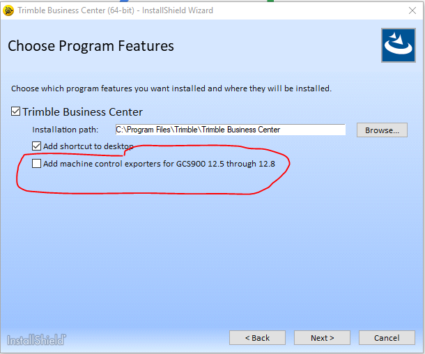

    When you installed 5.20 did you enable the following option?  These are now optional as they require system files that are more than 10 years old and no longer supported by Microsoft, hence may not get updated for security concerns.
