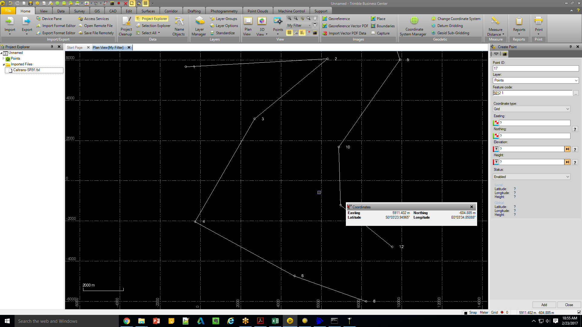

    In TBC how do we switch the coordinate scroll from displaying grid values to geographic values? See attached JPG for reference. Thanks you.

    See images and explanation below on how to do this:
    • Click on the coordinate scroll display in the bottom right corner of TBC
    • Additional dialog pops up
    • Right-click on this dialog and select Latitude, Longitude option
    • Now the scroll displays global coordinates

    Thanks Riley.
    I knew it was something like that, but I kept right clicking the top portion of the scroll bar which did nothing. Clicking down in the display of the scroll bar gets you that drop down list. Thanks very much !
