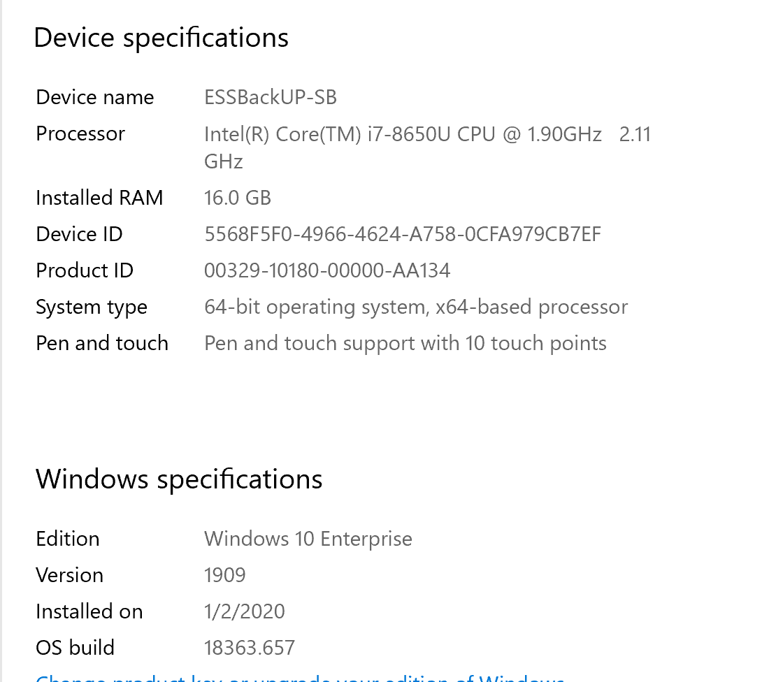

    I have a surface pro that I use only for travel and I hardly use it for TBC. Now, I am finally using it working at home because of the virus.
    Opening my TBC takes a very long time (10-15minutes) then it shows this "Command Registration Error" (below) and it will take another couple minutes to open it after clicking okay.
