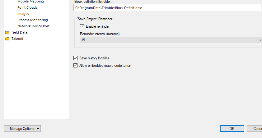

    Not sure you are aware of this in the options section. Though this doesn't auto-save, it is a nice thing to set up so that you do not lose work. You can set it to 5 minutes and you likely wouldn't lose much work in the event of a crash.

    From the TBC Help:
    Set a Reminder to Save Your Project
    Use project management options to set a timed reminder that prompts you to save your project. When enabled, the Save Reminder dialog appears at an interval you specify.
    Caution: Any time that you save your project, the 'stack' of actions that you can undo is cleared; you cannot undo past the last time you saved.
    To access the command:
    Select Options > General > Project Management.
    I added "autosave" to the topic as a keyword to make it easier to find.

    I set it to 30 mins and that is often enough for me - I dont see crashes too often in 5.2x
