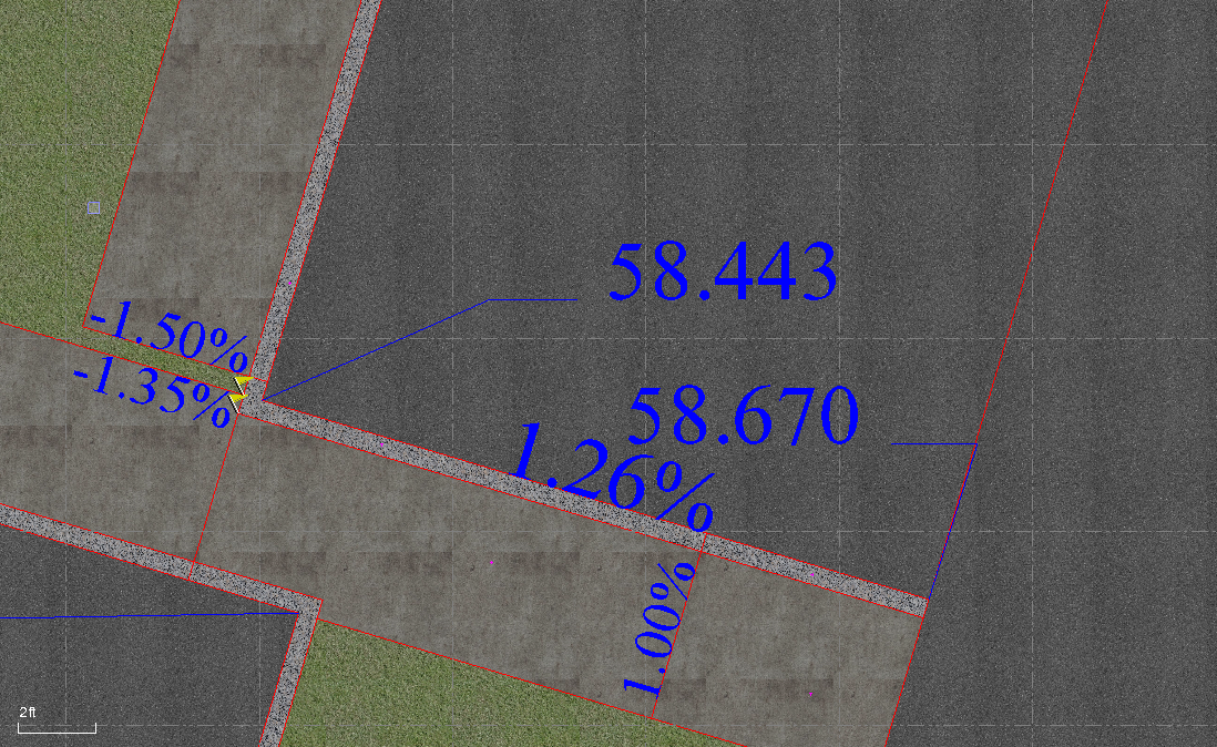

    What about something such as a top of curb and bottom of curb scenario? or top of wall and bottom of wall? I would ideally like to be able to do this with one leader line and one text block. I understand this poses some challenges because of the request to pull data from 2 spots with only one delineation. I have tried using a combo of smart  text with one pulling the elevation from the leader and the other pulling the elevation from an object but that does not work.
    Another thought I had was to accomplish this with a math equation. Add .5 ft to the elevation grabbed from the leader line and text. This would not give you an elevation pulled from the object but would allow you to consolidate text. If everything is model correctly this would work well as an alternative.
    I think there are other uses of math within smart text anyway. I am not sure if it exists. If not this would be a great #enhancementrequest.
    Thanks!
