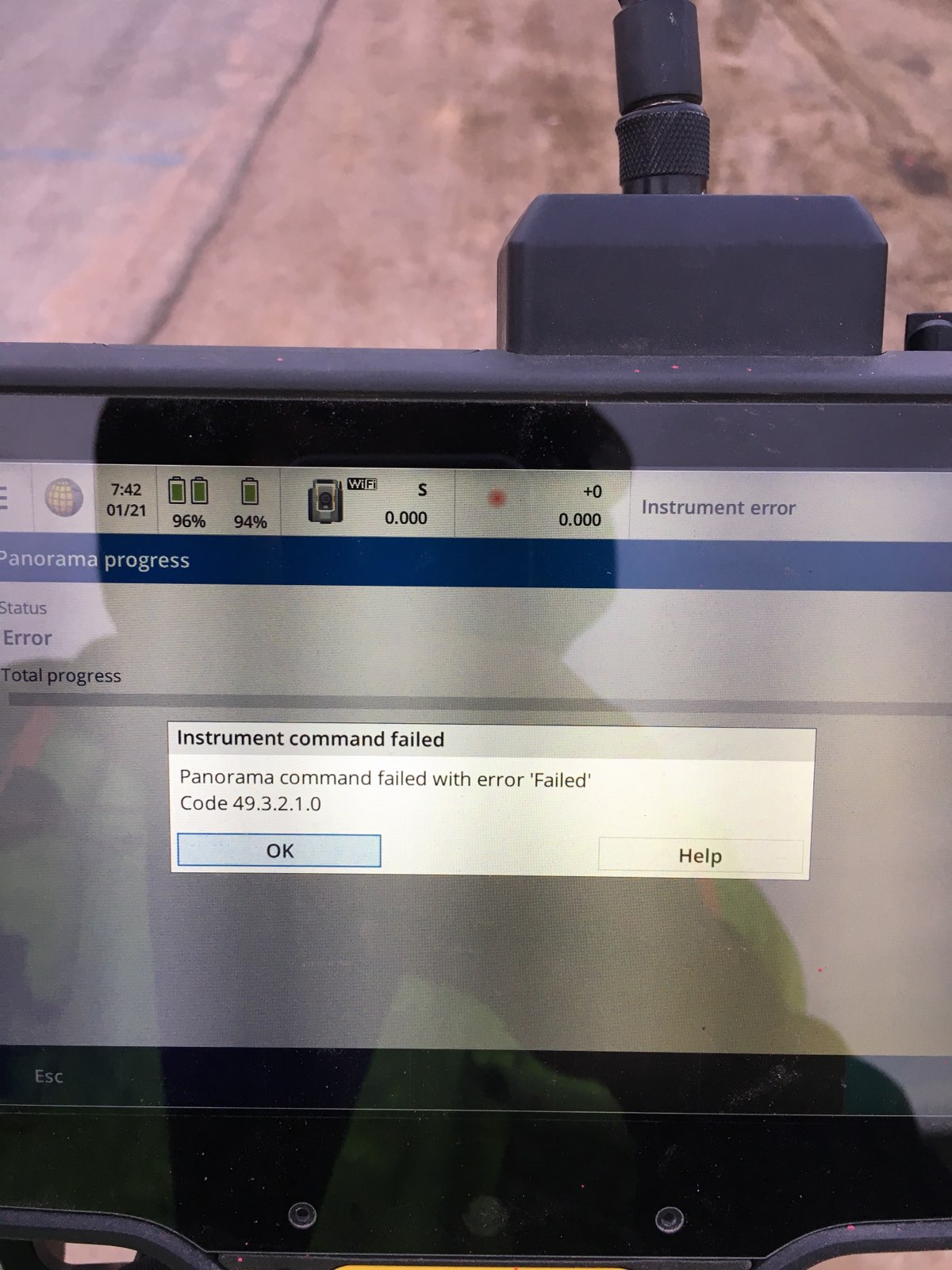

Trimble sx10 error code 49.3.2.1.0

    We are currently getting this and another error message on 3 dc's and 2 sx 10's. Any more info?

    Hey @Tysen Ellison,
    Had you manage to troubleshoot the above-mentioned error?
  • 4.  Re: Trimble sx10 error code 49.3.2.1.0
    Posted 04-17-2020 16:27
    The SX10 firmware is corrupted. Connect the SX10 to Trimble installation manager on a PC - install the latest firmware.
