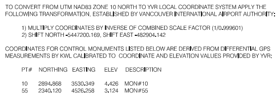

    3) If you have been given some data that allows you to compute the shifts - for example I was recently given the Coordinates of 2 points in a Local Coordinate System at YVR airport in Canada, as well as the LLH values for those points - and the Coordinate System and Zone info - you can create a Site Calibration using those two points to define the Site Cal required to get to WGS84 - here are my Notes from that process (This is the closest to what you have asked I think)
    My Notes
    Enclosed are 2x Projects set up in different ways to handle the Coordinate System Information and map to Google Earth. The data provided was as follows
    Project 1
    I opened the Project in Metric
    I elected Coordinate System - World Wide UTM then selected 10 North as the Zone and  then selected NAD 1983 Canada as the Datum Transformation and then selected CGG2013 (Canada) as the Geoid Model
    I then entered the 2 monument coordinates in the projection (not local coordinates) (these can be computed using the Shifts and Scale Factor provided in the project information above) (Local N + Northing Shift) / Scale Factor) etc,
    Having entered the 2 coordinates and the coordinate system, I ensure that I have a Connect connection set up in Support - Optons, External Services (my Username and Password) and test that it logs me in etc.
    Now I Toggle Background Map and the 2 points show up in the correct location at YVR.
    At this point I write down the computed Lat, Long, Height of the 2 points based on the selected Coordinate system. The LLH values are as follows (in the above coord system (note you would need to check the Vertical Datum / Geoid as that wasnt provided
    Project 2 (Site Cal)
    In this project I back calculated a Site Calibration based on 2 points - I know the Local NEZ values and I now have Lat Long Height Global Coordinates for those same points so I can use the BC-HCE Site Calibration to map the Locals to the Globals (and keep everything Local YVR Coordinates for the project. Note that this is a "Force Fit and is always a little risky with 2 points only.
