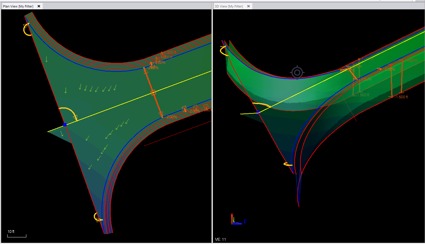

    Vertical Design won't compute a line with the cross slope rule. I can elevate the line using the connector rule but when I try to set a cross slope from the Center Line to the Edge of Pave it wont compute. Even if I delete the connector rule it still wont compute the Edge of Pave line with a -2% slope off of Center Line.

    The south most arc is a little off from being tangent so it can't find a solution from the start of the east west line.
    Extend the east west line by one foot and rebuild the vertical design.  It can then find the solution.
