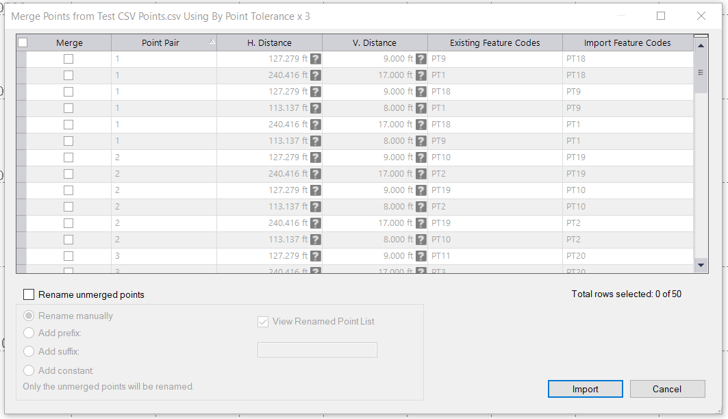

    I just tested this by creating points with ID 1-9 3x and all had different coordinates and code. When I drag and drop the file the data imports and I then get this dialog pops up
    From here check the Rename unmerged points check box and I typically add a prefix like AS and then it brings in all the points correctly as I would expect.
    I am not sure what you are doing different to me - whether I use Import and browse for the file or drag and drop I get the same dialog comes up.
    If you are not seeing this, can you send me a file and tell me which method you are using to import the data and I will take another look, but I am not seeing what you are seeing. Maybe you could record a short video as well if it continues to be a problem

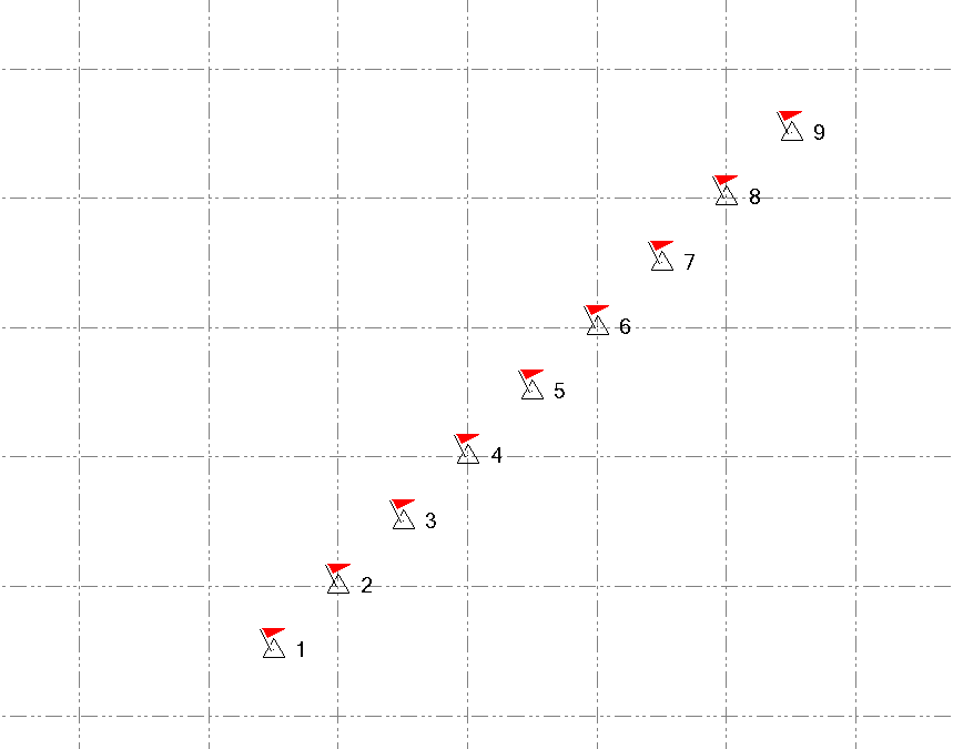

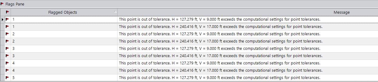

    In Both TBC v5 and BC-HCE v4.12 the behavior is identical. If you import as Unknown Quality you get the Merge Points Dialog Pop Up. If import as Control then the points get Merged and the Import Report has Warnings that Duplicate ID were encountered. Nothing has changed between versions as far as I can tell.
    If Importing as Control we are assuming that the Duplicate IDs are caused by Duplicate Observations to the same Control Points and all of the Points that have the same ID are in fact the same point although they may have different coordinate values. As a result they get stored on the same point ID in the Project Explorer, and if the point tolerance fails they get flagged Red in the list and Flags on the points and in the Flags pane. This is entirely expected and planned behavior for Control Quality Information on Projects.
