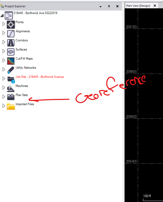

  • 4.  Re: Georeferenced Image - Separate Print Settings
    Posted 03-25-2019 05:07
    Alan,
    I think what would make this quicker is a specific group for georefenced images in the project explorer. #enhancementrequest Depending on the size of the project, you have to go through all of your imports and try and find the georefence images. This can be a nuisance.
    With a georeference image group, you could then quickly right click on the group header, select all and do exactly what you are suggesting.
