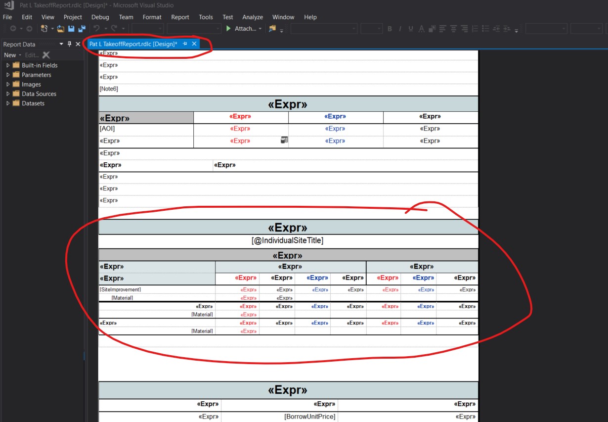

    I have created several rdlc reports for Business Center from taking the stock BC report, such as the earthwork report, and manipulating these to more fit our needs and layout. It seems to work well but my issue is that I cannot get the report to run side by side with the BC standard report, it is either one or the other. If I copy the custom report in the report database and try to run this custom report, BC runs the standard report by default.
    Is there a trick to getting the custom report to work side by side with the BC standard report? Until I feel comfortable with my step up, I want to be able to run the reports side by side for comparison. It is also a pain to keep swapping reports in and out of the report database.

    I have attached the following:
    • rdlc files for my custom report
    • a pdf showing what the pdf looks like with some comments on things that I need to tweak further
    • rough concept of an end goal that I would like to see showing: cut and fill map with takeoff breakdown
    There is a lot of good information in the Takeoff report but there are a few areas that I feel can get consolidated to make this report more concise.
    My biggest hang up right now is running this custom report side by side with the out of the box report.

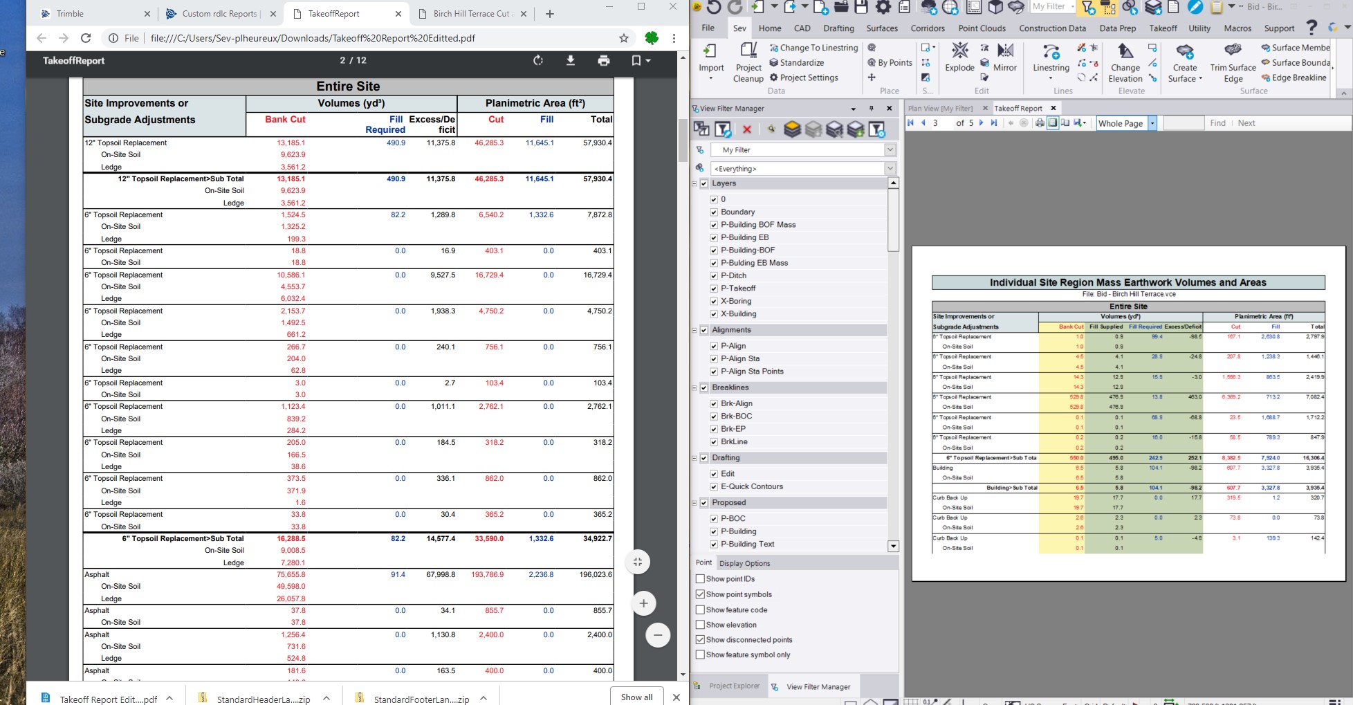

    I just ran through that again and it still looks like it is pulling the standard Takeoff Report even when you create a new report, shown below.
    In the image below, the left report is the custom report that I adapted from the BC report and the report on the left is what I get when I run through your workflow (this is the out of the box BC report). I also attached a video showing my workflow. Please let me know if I am missing something.

    Attached are the following:
    • TBC File
      • VCE and Takeoff Report Components
    • Takeoff Report as of 03072019 - Where I have got the Takeoff report to
      • Big take ways:
        • Custom Company Logo
        • Individual Site Region Mass Earthwork Volumes and Areas - Strata Cut Volumes
          • Gives you a break down of the cut volume for the strata layers I would like to be able to get the cut area as well. It does not appear to be possible with the current data available
          • This is valuable when dealing with unsuitable strata. It gives you idea on areas that can get raised to get out of out high points in the strata
          • The areas of strata cut are beneficial for our blasters. We typically need a area of the ledge, so they can base their gird pattern on this
      • I am getting closer but still running into issues
      • I still have not found a run to run a custom rdlc, so what I am doing is replacing the out-of-the-box Takeoff report with my revised Takeoff Report
    • Takeoff Report - End Goal - Where I would ultimately like to get the takeoff report to
