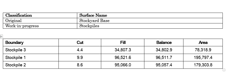

    I am trying to create a summary sheet for a custom report but the surfaces keep repeating based on the number of bounds I have selected. Is there a way to stop this from happening?
    I think it is because each bound is getting treated as its own surface to surface calc.
    Thanks!

    Like this you mean
    2 surfaces - 3 Areas
    Here is your report - I fixed the Values that you were using and also the properties applied to those values
    Hope this is what you wanted

    So I opened your report up and compared side by side. The surface change from the volume report category to the selected surface category makes sense.
    What is throwing me off is that you use the VolumeSummarySurfaceClassified values. I guess I would not intuitively think to uses these values. Why are these the correct ones to use and not the VolumeSummarySurfacetoSurface values, which is what you would expect if you are running the surface to surface function?
    That is very close though. Thanks for helping with this.

    Those are the values that are used in the native report o believe so I just used the same ones - no other reasoning than that

    Gotcha.
    Because if you use the Volume to Volume values you get blanks.
