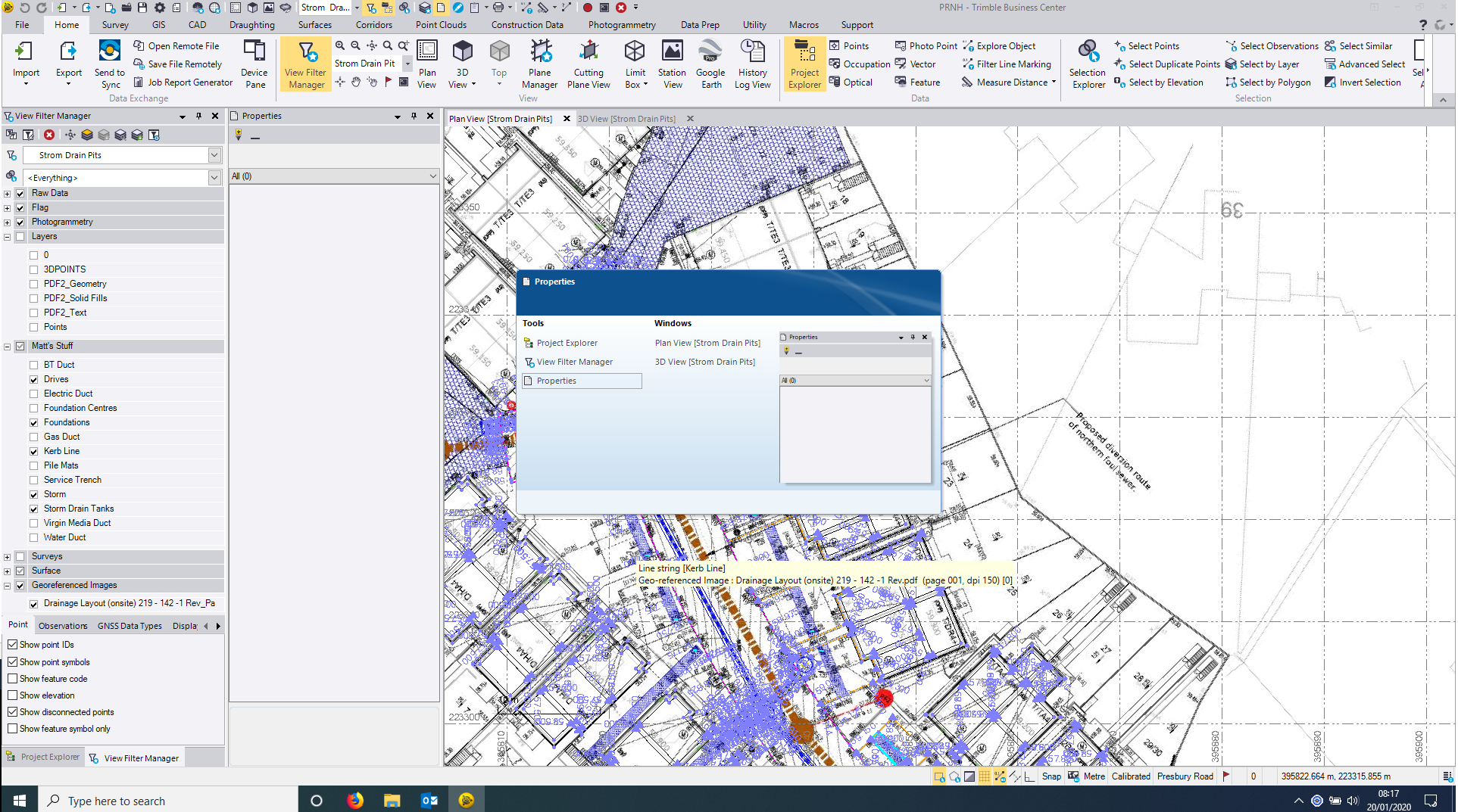

    I have lost the properties pane and cannot seem to find it. It doesn't appear to be hiding.
    I tried some of the windows tricks and none of these seem to work. https://www.techjunkie.com/find-recover-off-screen-window-windows-10/
    I have also tried:
    • closing TBC
    • Restarting my computer
    • Checking resolution settings
    Absolutely weird.

    select something then press f11 and see if you can tell where it is.

    You can check if it is open and hiding by holding Ctrl + Tab, this should bring a list up of open program components, try doing that then hitting F11 and hitting it again, if the properties pane shows up either time then it's somewhere off screen.

    Unfortunately I was working on some time sensitive data on Friday and did not have a lot of time to mess around with this. I ended up fixing it by restoring TBC settings to their defaults and reloading setting configs.
    I did try you trick @Tim McClannahan and was still not able to find it until I did a reset on the settings.
    The only other time this has happened to me is with a custom floating tool bar.
