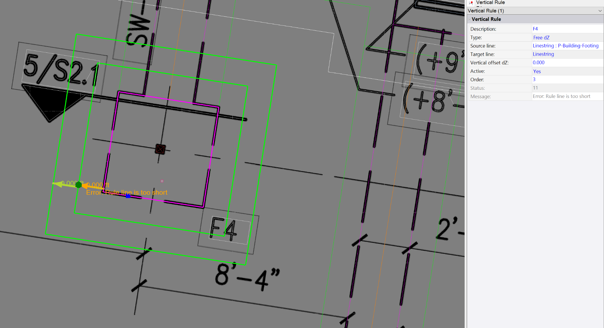

    Please consider for the next release. I have run into a few issues with this and not being able to grab the grips of the instruction.
    One good case is when you get an error that the instruction is too short.
