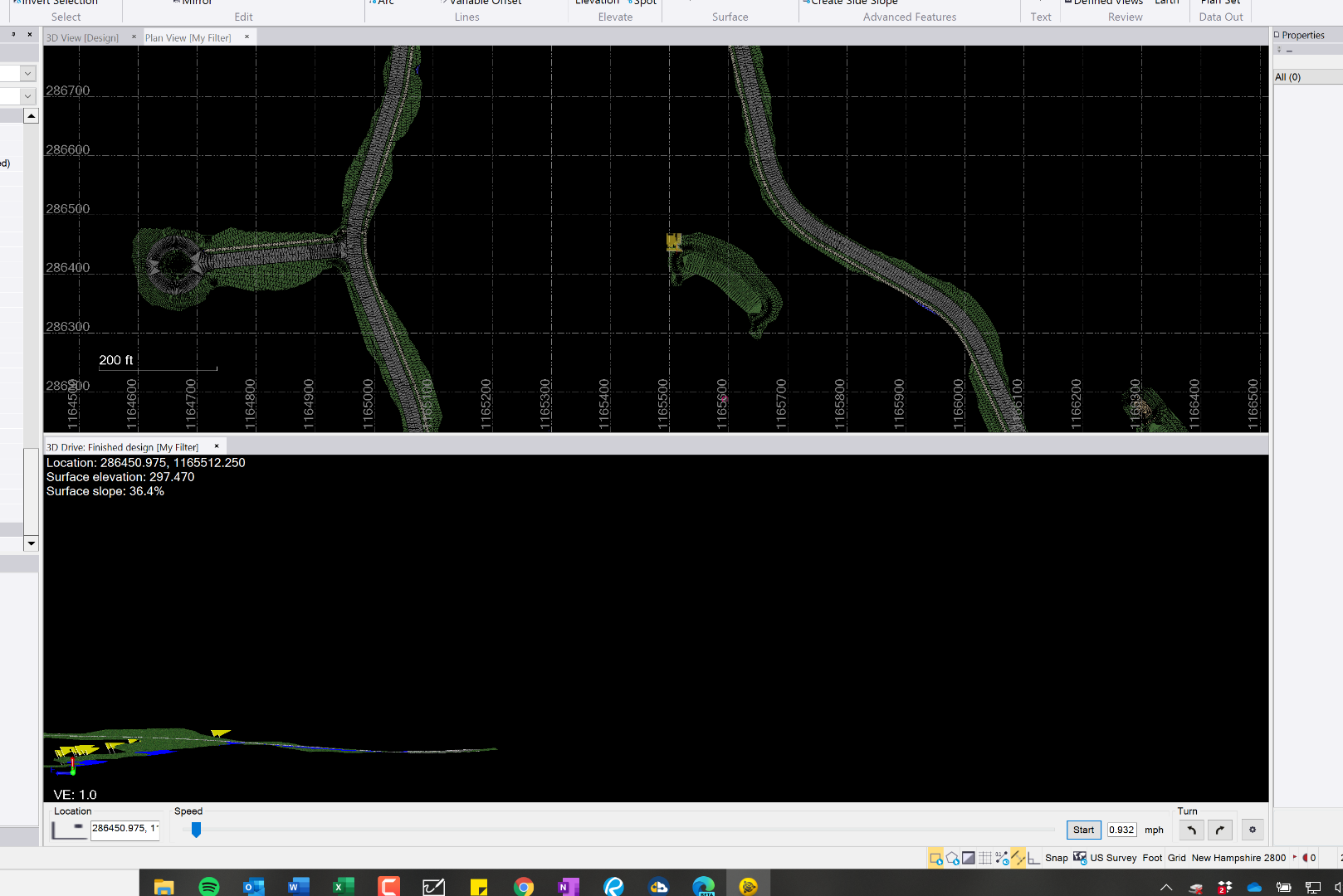

    TBC has the ability to drive an alignment but in other CAD software programs, you have the ability to drive the vehicle around wherever. Agtek and Carlson are 2 programs that support this.
    The value in this is getting perspective of the model that may not be alignment based. The other value is if you can change vehicles; grader, truck, dozer, you can show scenarios and how work is intended to be performed.
    User input; have the user choose the model they want to analyze and this is what the vehicle would use for the height.
    #enhancementrequests

    Just choose a surface instead of an alignment? They've always had that option. It's always been a dozer as long as I can remember.
  • 3.  Re: Feature Request - Drive Model
    Posted 01-31-2020 07:01
    Oops missed that one. Thanks Erik
    It looks like my dozer is stuck on an island though. I don't think this function likes surface islands and I cannot find a way to set a start position. It looks like it defaults to the relative middle of the overall model.

    TBC's current option of "driving" the surface or alignment needs work. I don't see an option to select a vehicle (dozer).
  • 5.  Re: Feature Request - Drive Model
    Posted 02-04-2020 16:38
    It’s only on plan view. It is also a little faulty. I keep getting half a dozer.
    I also haven’t found a way to set a starting point.

    Just click location in the bottom left, then click location in the plan view, no?
  • 7.  Re: Feature Request - Drive Model
    Posted 02-05-2020 08:00
    Ugh. Yes that worked. Was looking on the other side of the screen and totally missed that.
