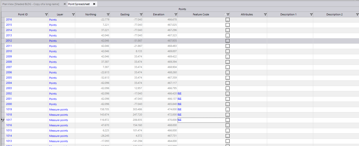

    As someone that prepares as-built data, it would be very useful to have a way to quickly correct text that is misspelled or incorrect.

    consider using the points spread sheet.  You can select them here and change the common property in the property pane.  Advanced select can also be used to search for common parts of a property.

    I think I tried this but it didn't quite do what I wanted to. I will give it another go and give specific feedback to this function.

    Very much agree with you. I wish something similar was integrated into TBC, especially this spreadsheet view.
