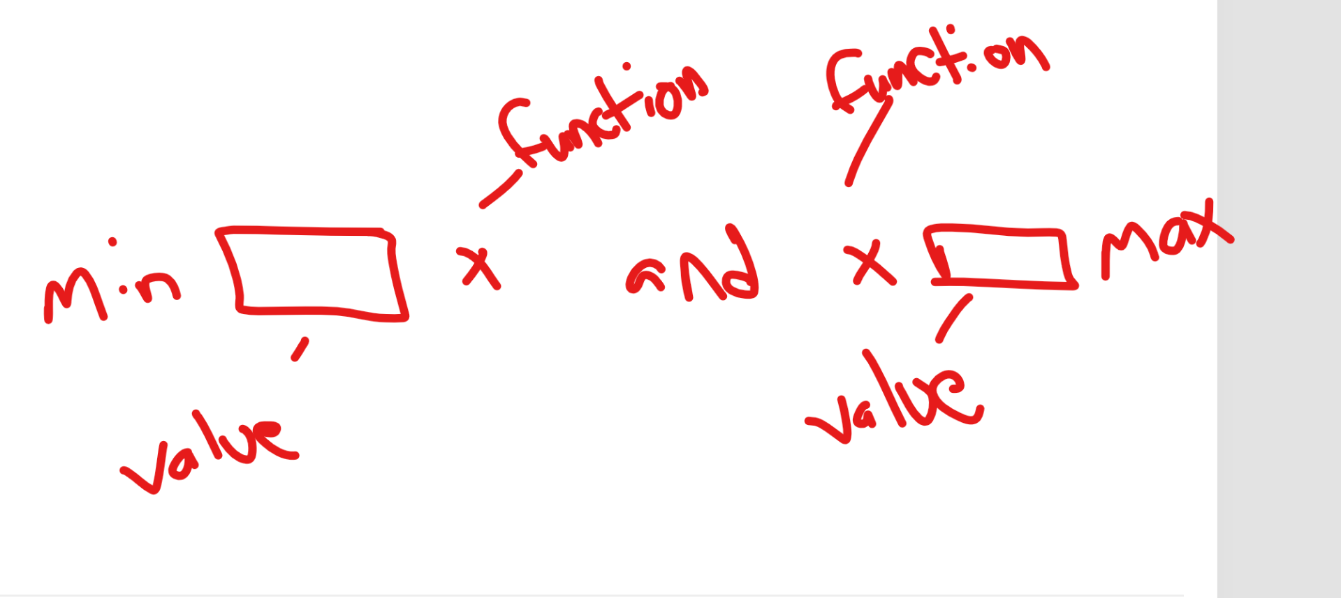

    Understood. You can do it this way it is just not the smoothest process, especially if you are doing this repetitiously. I find myself getting more discouraged than seeing successful results. I will try and document specific issues.
    Could the max and min get rolled into one function with a term that would just not apply to that set end. This would save at least 4 steps.
    i.e
    max
    min
    if you don't have a min put in na
    if you don't have a max put in na
