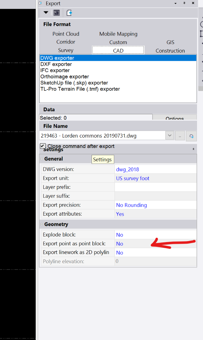

    I received the following issue when trying to export a dxf. I have not seen this before. The attached vcl contains the data I was trying to export.  I also revived this issue when trying to export a dwg.

    I had to turn off export as point block and it worked.

    What software is that? That open window in picture ?>
  • 5.  Re: Issue exporting dxf
    Posted 02-16-2020 03:32
    All the windows shown are TBC - it is the Export Command where you choose the tab for the exporter you want
    this is TBC v5.2
