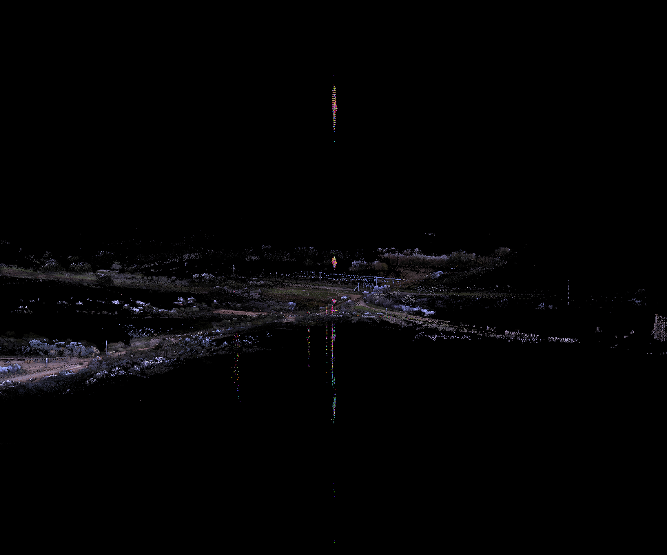

    TBC is defiantly not optimized for Dropbox.  I also use Dropbox for all off my projects. When I bring scan data from the SX10, I have to start the project outside of the Dropbox and then transfer it after all data has been imported. If the project is in Dropbox, I get these crazy point anomalies that shoot vertically above and below the project to what seems infinity.
