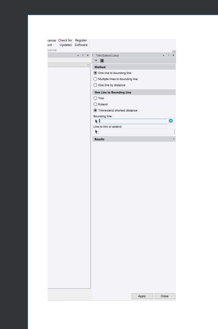

    The trim/extend command - One line to bound line would be another great place for this

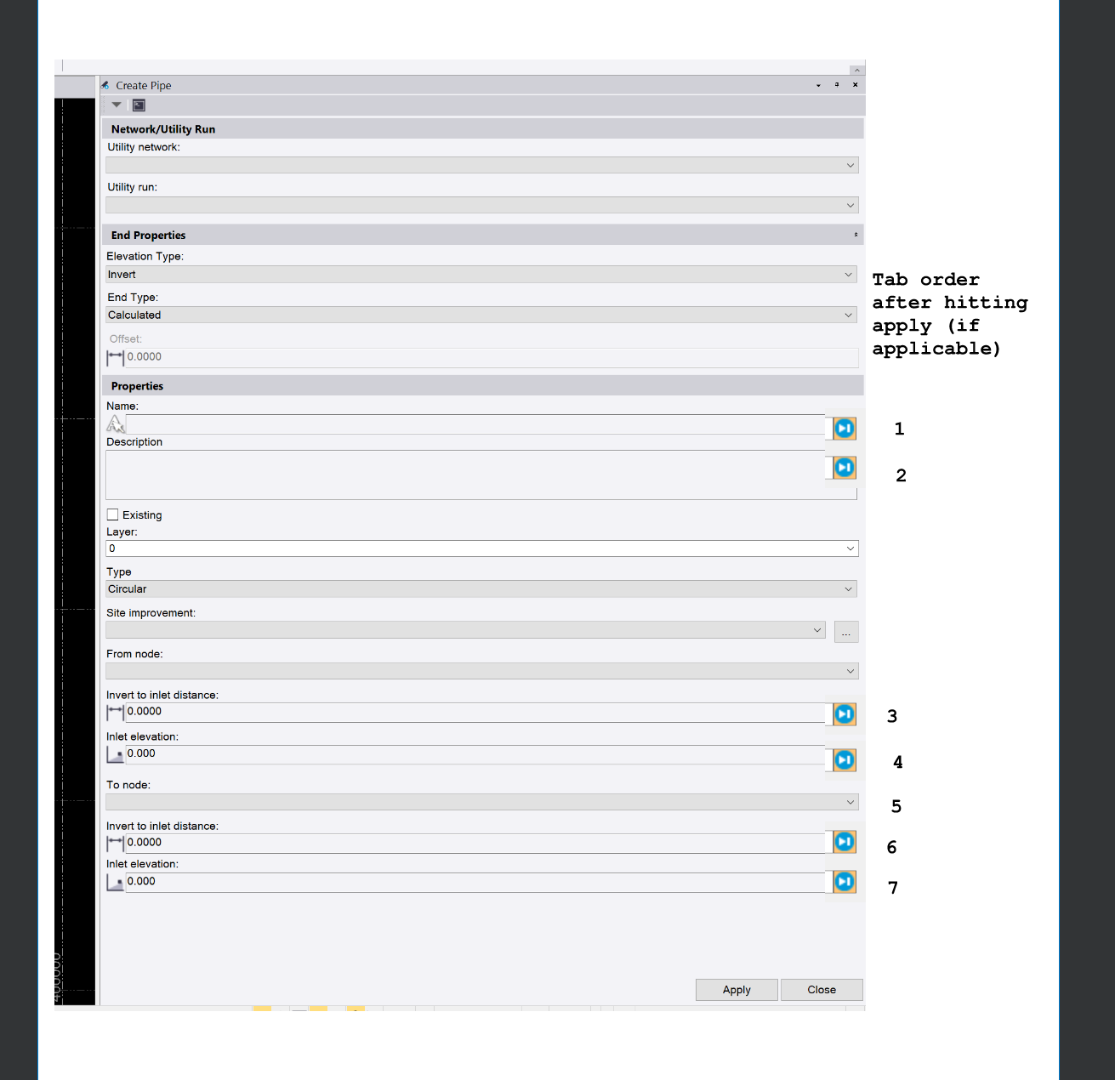

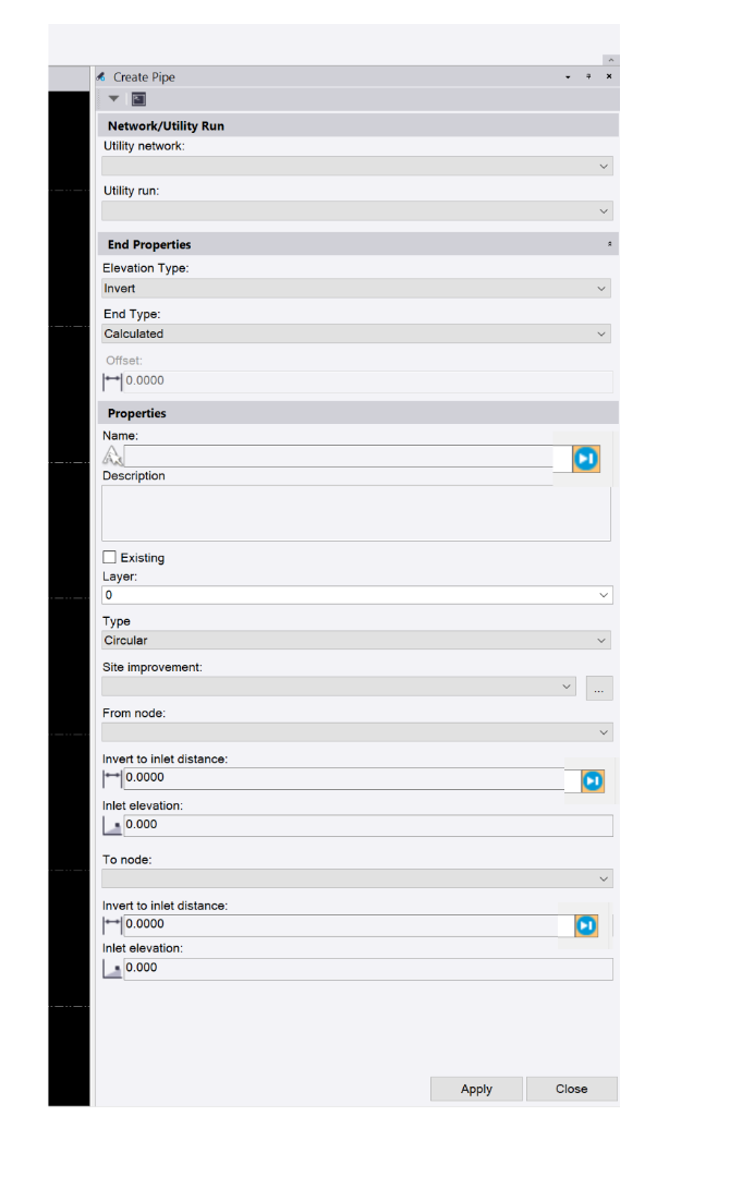

    Create Pipe
    By default I would like to always skip the invert to inlet distance
  • 20.  Re: Feature Request - Break a Line - Auto Advance
    Posted 03-20-2020 12:32
    Something else to note here, when the from node or to node is active, there is no real delineation that this control is active. Maybe highlight in blue or a blue active dot.
  • 21.  Re: Feature Request - Break a Line - Auto Advance
    Posted 03-20-2020 12:41
    Actually this would be more preferable and please note the recommended tab order. Debating if the form node should have tab stop and a sticky for lateral runs.
    The issue with the tool right now is it assumes that when you create a run, the form node elevation is the same as the last to node elevation, which is not the case most of the time. There is usually (at least in our area) at least .1ft difference between the invert in and the invert out.

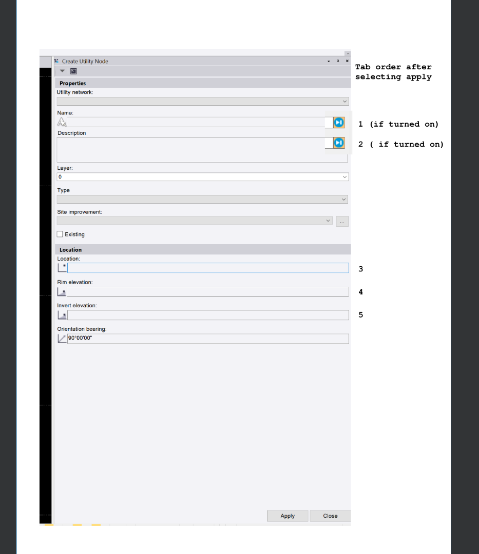

    Create utility node
    Also please note the recommended tab order that I think would help speed up this tool
