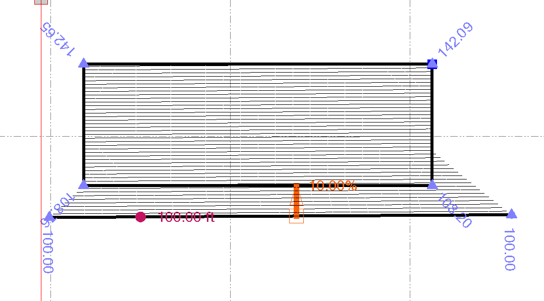

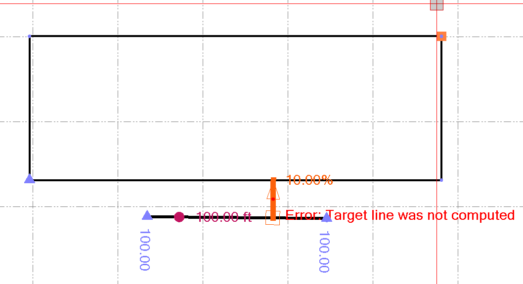

    For example you can do a Cross Slope from a line to a closed linestring but the source line has to cover the entire range of the target line - otherwise it cannot be computed because the cross slope affects the whole of the Target Line from the whole of the source line
    So this situation fails

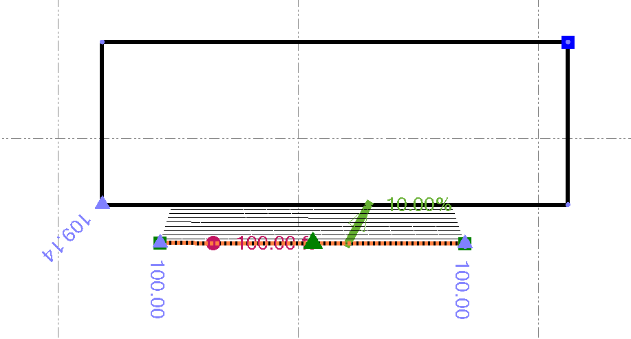

    But this one passes
    However a Free slope only affects one point on the Target Line and so can work in the first scenario
    So when you say it doesn't work - it actually does, but only for certain rules and certain conditions. We analyze the request and the available geometry and we don't let it do "wrong things"
