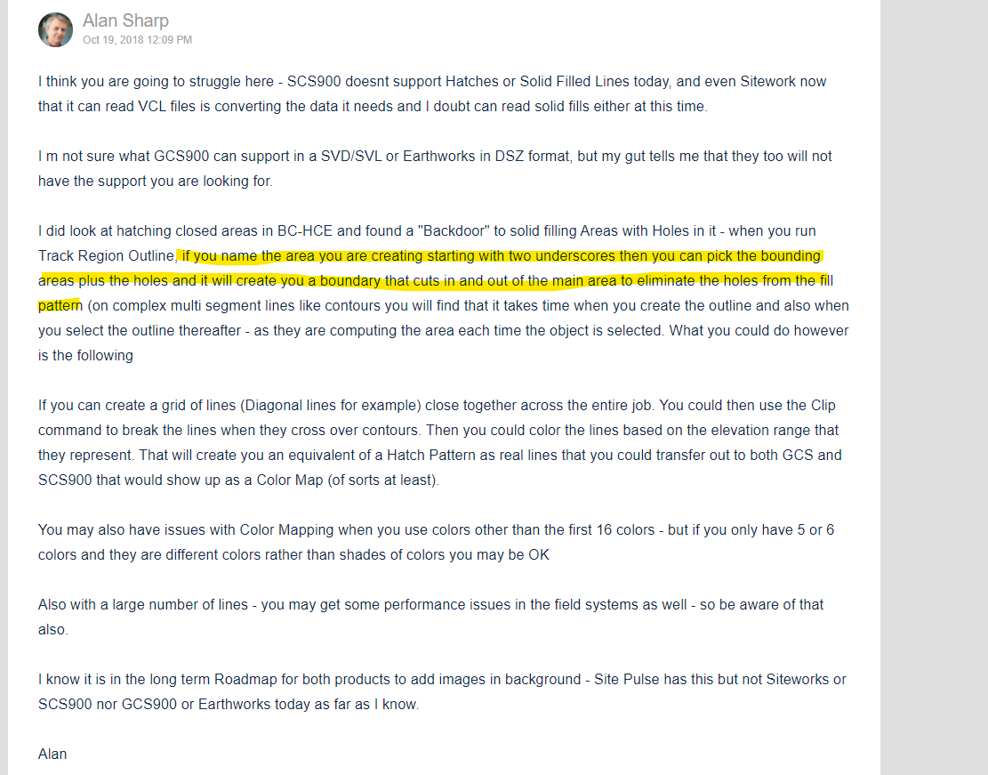

    There was a trick with track region that was very useful but I already forgot it. I feel like it had to do with adding an underscore "_" in font of the name of the region line.

    This?

    This would be great to have integrated into the actually command or at least a hint in the interface. The leg work is done and this is a very useful tool.
    Hint " Use two underscores .ie."__" to create donuts"

    Agreed.  This trick is a HUGE help and should be part of the standard function.
