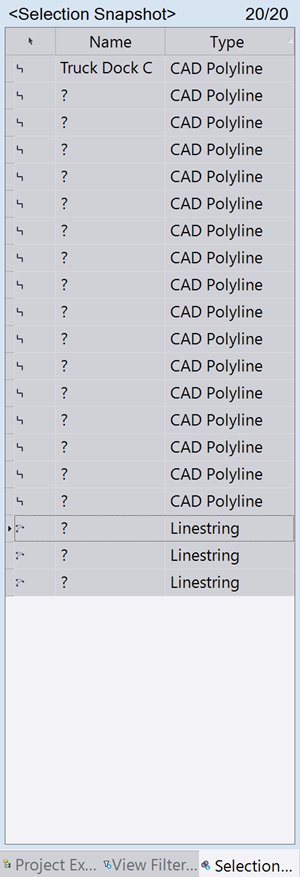

    Hi Tom,
    It looks like something was added to the design which TBC is unable to publish to the design, or is unable to sync.
    I would suggest looking through the design and seeing if there are any unusual objects which were added to it on accident. One way of doing this is to selecting all objects in the design then opening the selection explorer.
