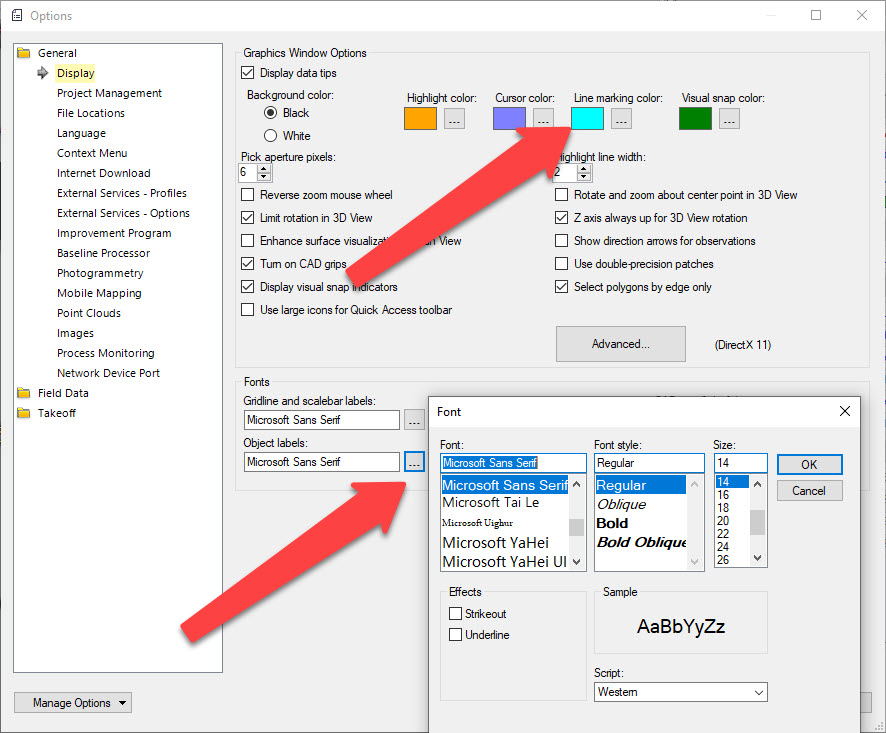

    Go into Support, Options and then in Object Labels at the base of the settings screen you can change the Font and Font Size, Bolding and Italics etc on these Text Items when displayed

    Just to add on to the correct answer, the COLOR is also set in this options group as "Line marking color:" (as indicated on attached screenshot).
