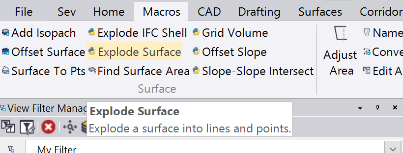

    You can add this surface as a surface member to the original takeoff surface. This is how I usually go about it.
    Otherwise you can use the macro explode surface.

    Hi Patrick
    That worked perfectly, thanks for your help!
