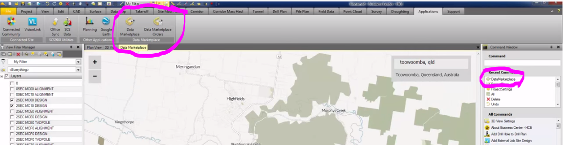

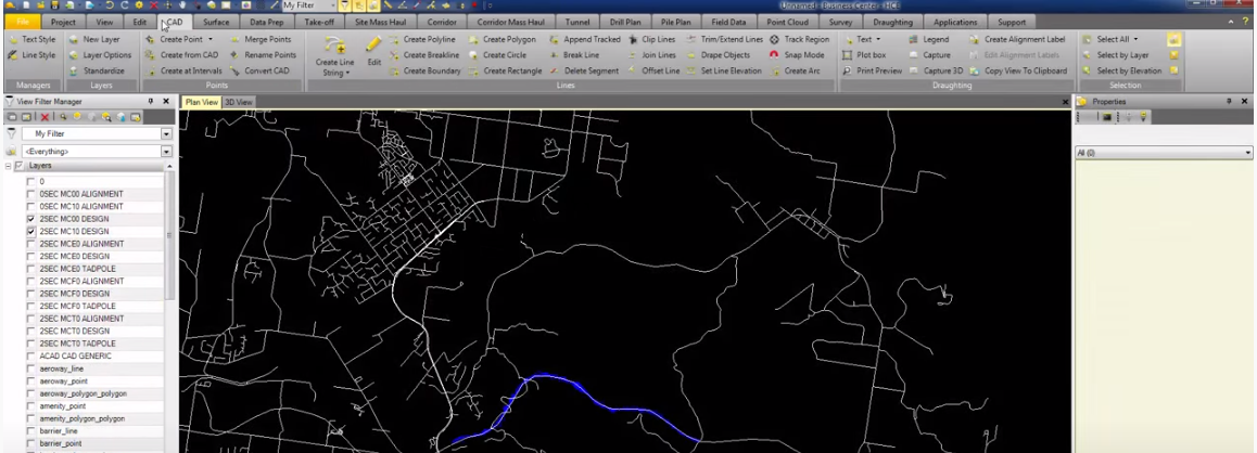

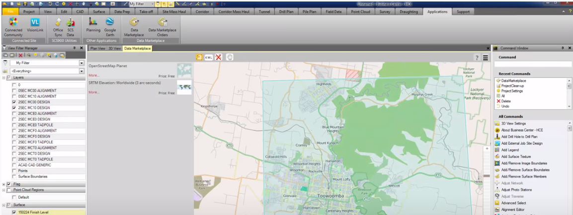

    I can get the background map fine, what I want to do is download the local roads linework, which you were able to do on the older version of TBC
    (but the command has been removed from the current version)
    Take a look at the video sitech done for a tender takeoff
    YouTube about 7.30 min into the video
    First select area and download the local road (8.00min youtube)
    this downloads all the .shp files which are useful when creating a haul route (this is the data I'm after)

    The geospatial Team I believe shut down the Digital Marketplace so the
    service is not there any longer to draw from. You can still import the SHP
    files if there is a government site you can access the ESRI SHP files from.
    I assume that this is why the command was removed by the Geospatial team.
