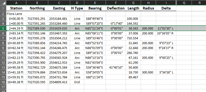

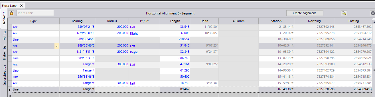

    Posted 04-07-2020 06:34
    I just ran a Geometry report on a alignment and found that it was giving me a bad bearing.  I then ran a Alignment Report and gives me the bearing i used to build the alignment.  Why is the Geometry report giving me a different bearing.
