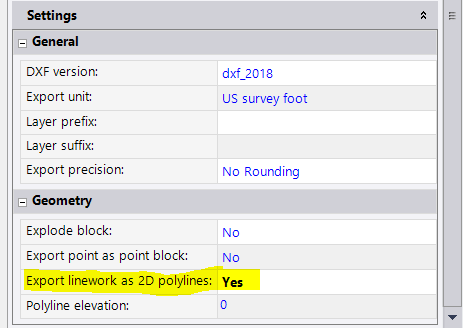

    After updating LW and sending it to the field I got a call that the station line was missing.  I looked into it more and its not missing its getting cut off at the limit of my surface.  The LW that was added was gore area updates, so it had nothing to do with the alignment.  This job has been going for over a year now and has had a ton of updates not sure what happened. Any ideas?

    I've seen the alignment linework trimmed to the extent of the vertical profile(alignment) applied inside of TBC. A possible workaround would be to try;
    -   copying the alignments that are trimmed
    -   in the copied alignments, delete any vertical profiles in project explorer
    -   export these to the sitemap
    (or)
    -   add additional vertical profile information to to the alignments, in the areas missing.
    Hope it helps.

    Thanks Joe
    I exported the line work as 2D polylines and that fixed it.  This isn't ideal for field work but they'll get by for now.
