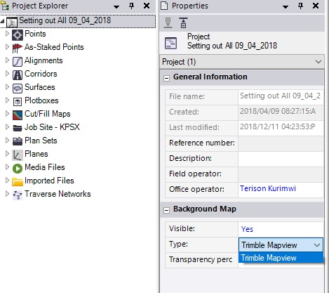

    Hi Matt, Thanks but, on the type, only Trimble Mapview is selectable and nothing else appears. See image below.

    Please send me an email at matt_mclean@trimble.com and include your license keyID. I will fix this for you.
    In transition from v4.10 to v5.0, the basemap functionality was moved from the GIS module to Survey Intermediate.
    Sorry for the inconvenience,
    Matt
