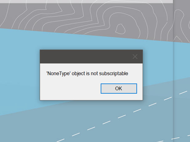

    Getting an error message "NoneType object is not subscriptable" when I launch TML Status.

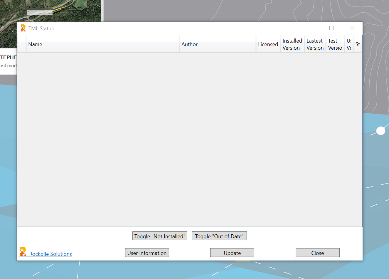

    Clicking OK results in TML status page being blank.

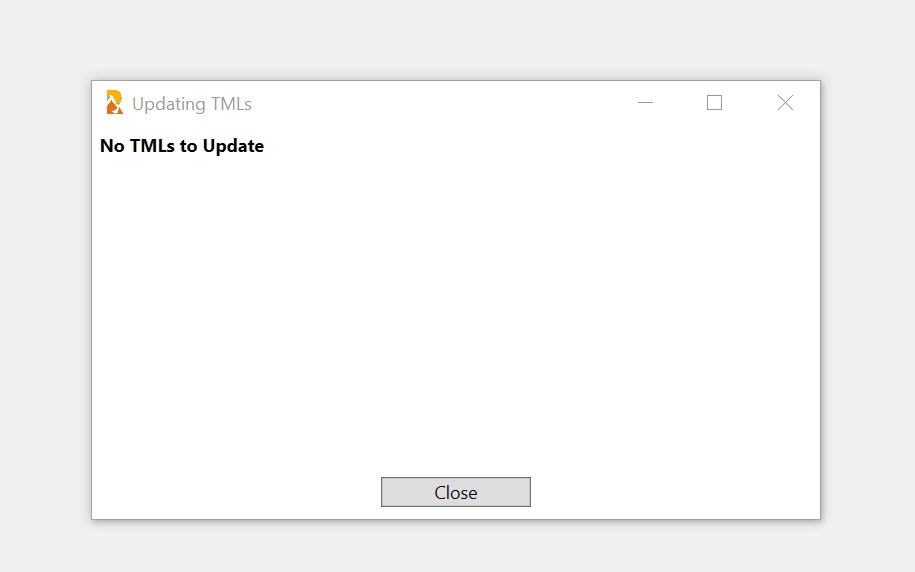

    Clicking update says "No TML's to update"

    TML Status Error Screenshots in the order that they appear.
    After clicking "TML Status"
    After clicking "OK"
    After clicking "Update"

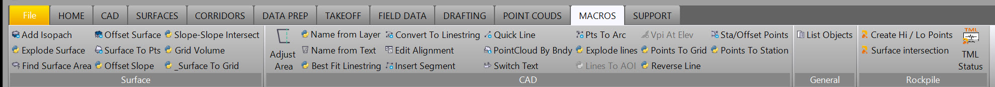

    This is my MACRO Tab. Nothing greyed out.

    Exactly the same results. I tried testing before any interface customizations, after customizations, and everything in between. Major difference is that the Macros Tab now shows most TML’s greyed out whereas before none were greyed out.
