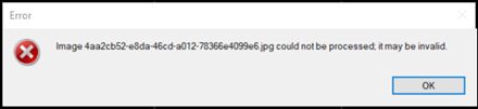

    Tried playing around with OpenGL and DirectX and Notiling+Down-Sample 8192x8192. The latter one gives me the following error

    If I use either of the downsampling options I get an error message
