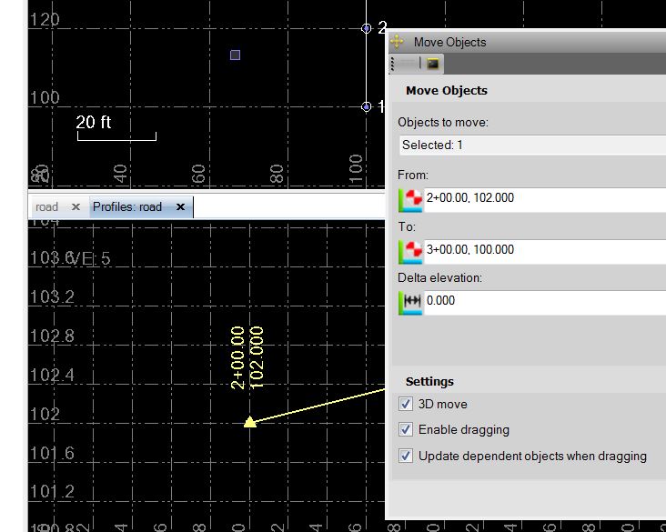

    Moving Vertical Alignment
    Select vertical alignment- Move Objects command- several entry options for From and To.
    This example is using station and elevation.

    Thank you Daniel. It worked.
