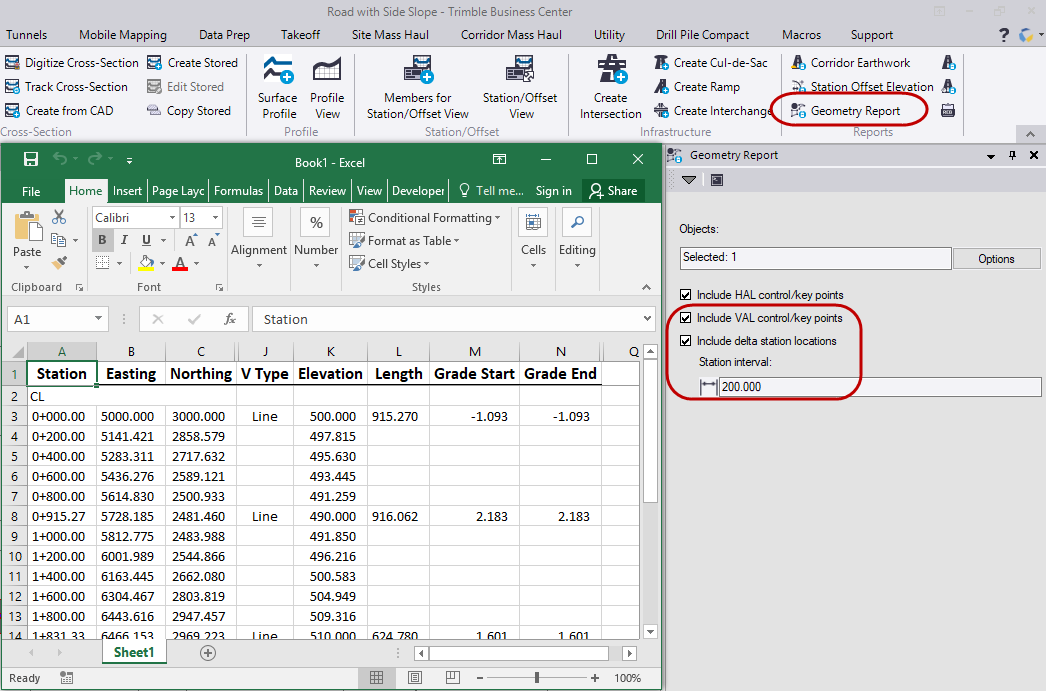

    Hi @Juan Serpas Serpas, what elements would you like to see in the report?
    From the Corridors tab -> Geometry Report, you can type in the station interval and create a report as below. Would this work?
  • 3.  Re: How to print a report using tbc from vertical alignment at certain interval
    Posted 05-27-2020 12:42
    Thank you Rui. That worked perfect !!!. The problem was I did not have the Geometry Report icon on my ribon
