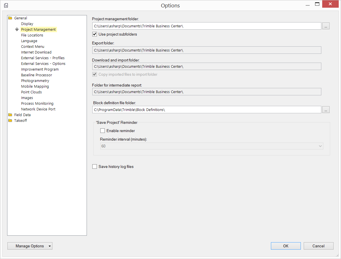

    I have also heard that the History Log Files can really bog you down on bigger projects - if you never use it - turn it off in Options / Project Management and uncheck "Save History Log Files"
