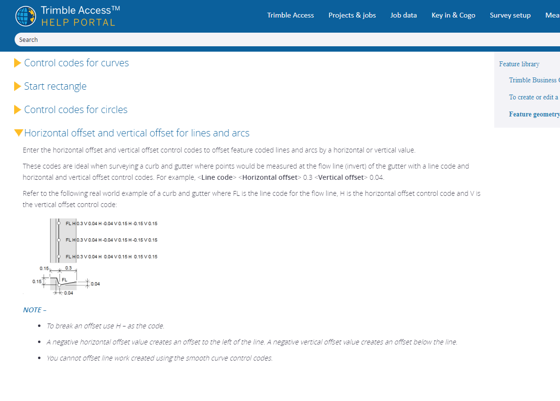

How to create the offset lines with single point observations because it is not possible to take observations of the drainage channel. Only one point can be observed in between  the channel, the other edge are by measurement only.
  • 1.  How to create the offset lines with single point observations because it is not possible to take observations of the drainage channel. Only one point can be observed in between  the channel, the other edge are by measurement only.
    Posted 11-19-2018 05:17
  • 2.  Re: How to create the offset lines with single point observations because it is not possible to take observations of the drainage channel. Only one point can be observed in between  the channel, the other edge are by measurement only.
    Posted 11-19-2018 12:26
    Hi Ahmed,
    Let me know if I misunderstood. If using Trimble Access in the field, offset lines using single measurements can be entered using feature codes. The offset follows a series of points drawing a line on one side of a channel, here is documentation for this:
    Feature geometry control codes
    Let me know if this answers your question!
    Thanks,
    Matt
