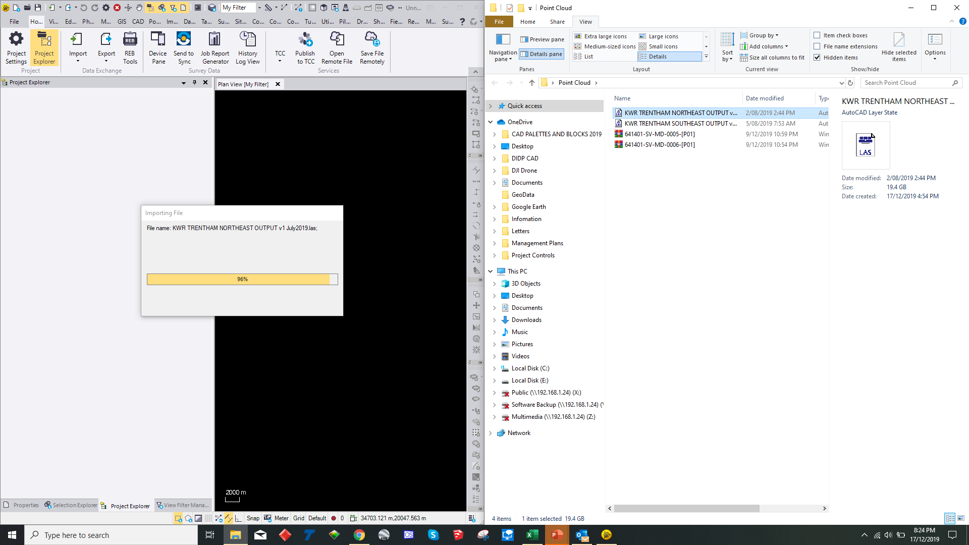

    Hi
    I have just updated my TBC to v5.10.2.  I am trying to import a point cloud into a new project file and it gets to 96% then the program just hangs up.  Is there a problem with this version.  When I try the same file in my old HCE V3 it goes in no problem?
    I have tried with different sized files and always hangs up at 96%.

    I have the same problem on v5.2 but it is a large data set 20gb
    Is there a limit to the file size that can be uploaded
