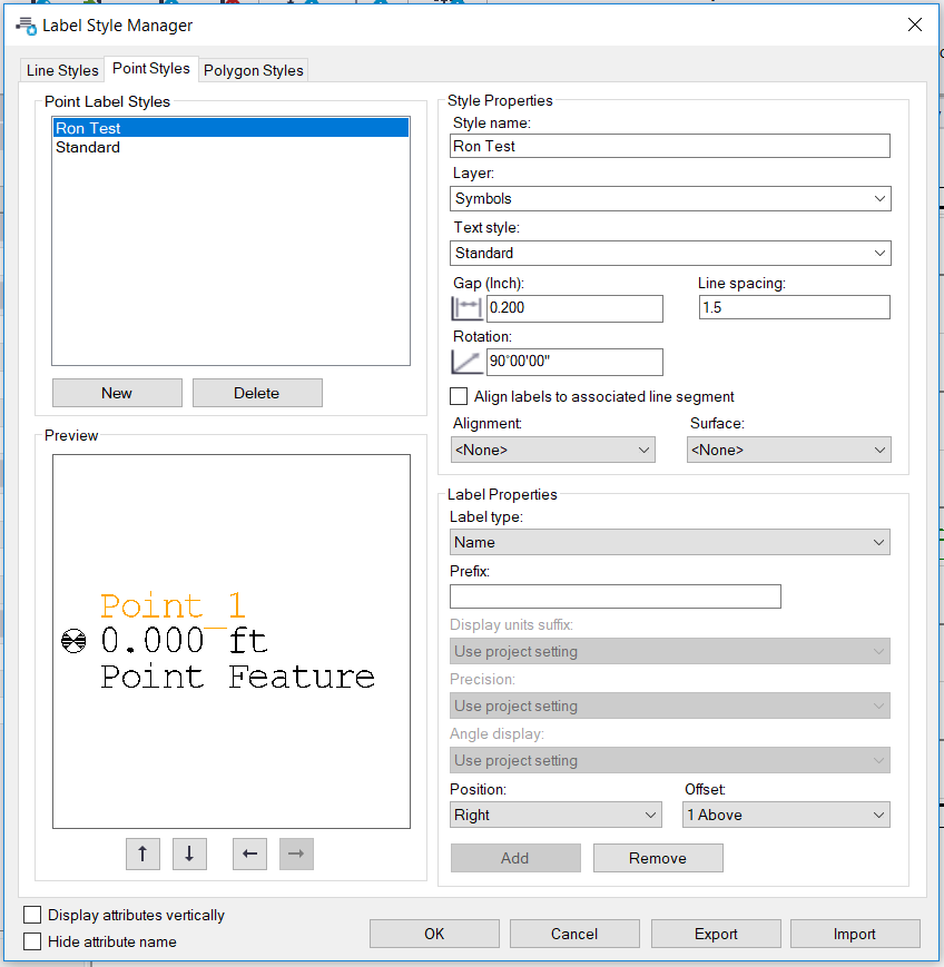

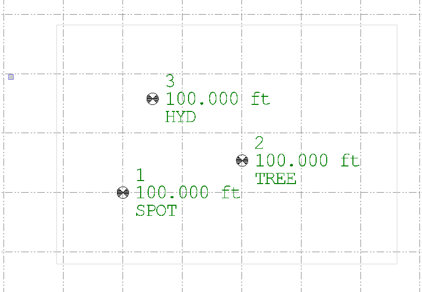

    I create a Point Label Style called Ron Test
    I then label 3 Points in the Plan View with these Labels

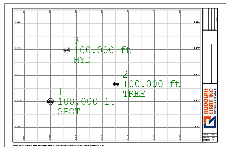

    Make sure that in your View Filter Manager - at the base - make sure that the View Filter has "Show Point Symbols" turned on (same applies to the View Filter that you apply to the Dynaview that you place in Sheet View
    I then use Create Dynaview Collection and create a DV 1 Column by 1 row at a scale of in my case 1:20 and of the width and height set up by my planset - the light grey box in above picture.
    I then add that Dynaview COllection to the Properties of my Imported Plan set and then use Build Sheet to build the Sheet View
    And this is what I see in Sheet View (above) (The Point Symbole are visible.

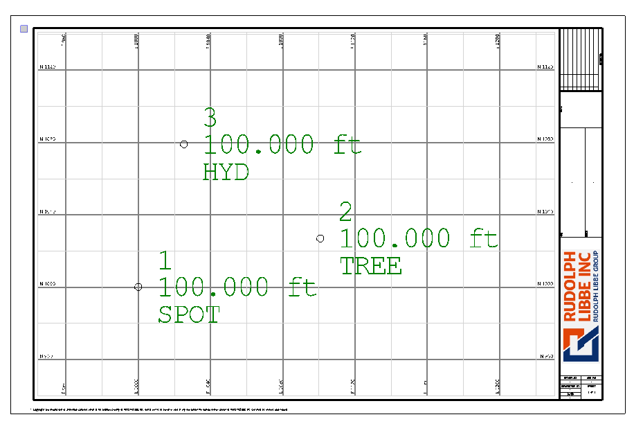

    If I however edit the View Filter "My Filter" and turn off Point Symbols at the base of the View Filter Screen, and then apply the My Filter to the Plan Set and Rev=build the Sheet this is what I get
    The Point Symbols are now missing - so I guess this is maybe what you are doing wrong - can you confirm that this is in  fact the case. I don't think using any shape for the Dynaview Frame - whether it be a Circle, a rectangle, a Plotbox or a Dynaview Collection has any effect on this - so I think this will solve your issue (I hope)

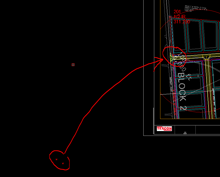

    Posted 04-03-2020 12:18
    Alan,

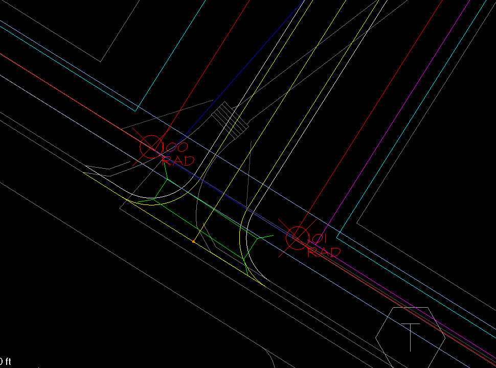

    I seem to be having trouble with this too and at first it looked like this was my problem so I followed your advice above but still nothing.  I was able to find my point markers in my sheet view but the point marker are shown outside my dynaview and away from where they should be.  These two markers should show the radius points for the main entrance apron.  The text is where is should be but not the markers.
    This is what it should look like (from Plan View).
    Here is the label style manager for those two points.  FYI I can't seem to get the other styles to work right either.
    Please let me know any advice on this.  Thanks!

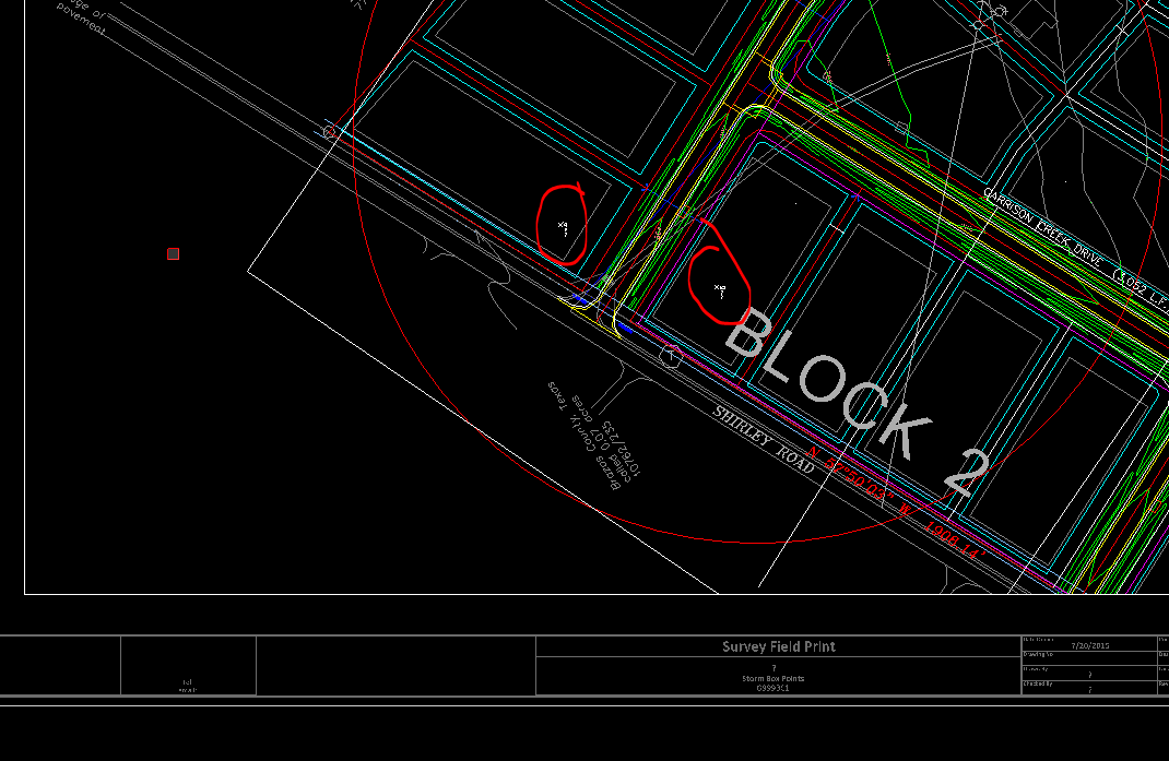

  • 10.  Re: Dynaviews not plotting point symbols
    Posted 04-09-2020 13:35
    Just updated to 5.21 and still can't seem to get it to work.  I did find that if I created a dynaview that is aligned with the axis of the plan view screen then everything seems to show up correctly but if the dynaview is at an angle then it has a problem.  I confirmed this using a new file and just a few sample points.  Can anyone else confirm this too?
