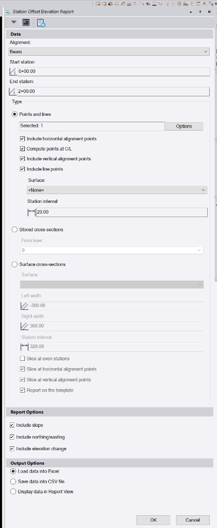

    I just created an example Beam on a straight line 200' long with a Symmetrical VC in the middle, and then I ran the Station and Offset Report - you have to make sure that you check the box to report "include horizontal alignment points as the Start and End are Alignment Points not Interval Locations as shown below. If you do that you should get a report that looks like the one shown below - you can see that Station 0 and 200 are reported as would be expected

    Am I missing something here or does this answer the question?

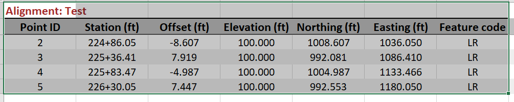

    This is not exactly what happens when I run it. Here are three examples. The first is when I have everything checked as shown in your example. This has all sorts of data I do not need. The second is if I only check “Include line points”. This is more what I would want. Problem is neither report has #21790 in it. The third is the same points in a Terramodel report. This has everything I need and what I am used to. My other question is if I have a point that is past the end of the line, can I include it in the report? In my TM report you’ll see there are two extra points. One before the start and one after it ends. Is this possible in TBC? It seems like if a point is beyond the line in either direction, it will not be included in the report. I also attached my “alignment” and the points. Thanks.

    The current report does not report points that are outside of the alignment, only those inside the alignment limits. There are issues when you start reporting data outside of the alignment limits of course like "what is the elevation delta to the CL (you can of course leave that blank or not report Elevation Deltas" what is the Station Value and how is that computed - when we Explore objects in relation to an Alignment we don't currently report a Station and Offset of the point if it is outside the limits of the alignment.
    I can ask Development what it would take to add that capability, I am sure that it is possible, but there may be reasons why it is not currently done.
    The report using these settings will generate the same data as the Terramodel Report you shared with the exception of the points outside the limits of the alignment. The Elevation column is in a different place to the Terramodel Report, otherwise the report is all but identical. ( reported only Points and did not select the alignment.
